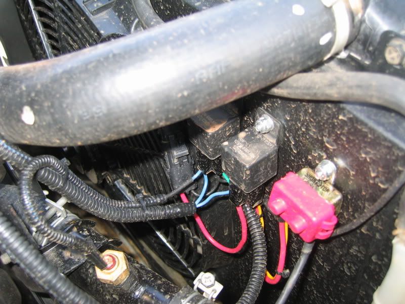

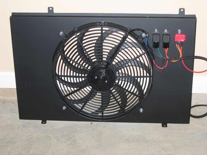

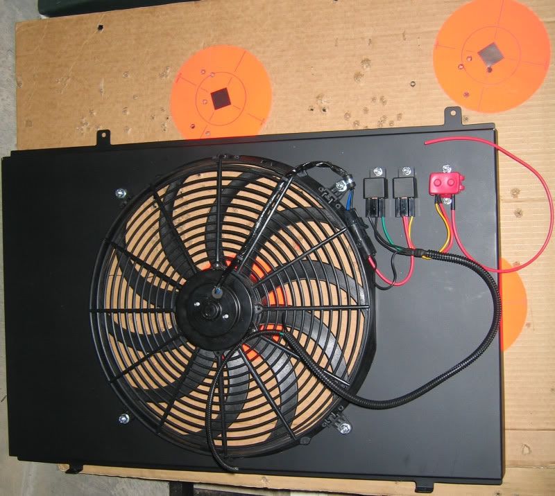

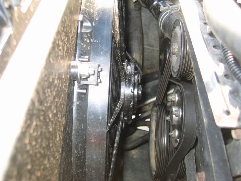

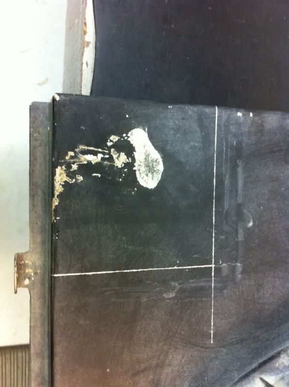

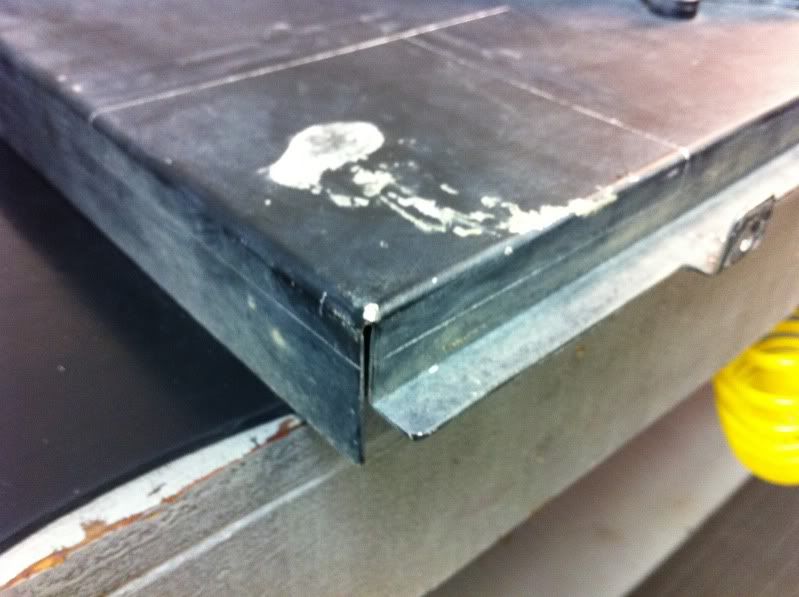

Ben mine is wired with a switch for OFF-fan will not run, ON-fan runs continuously, and AUTO-fan runs when coolant temp exceeds 180F or when the AC compressor cycles on.
Pics of the unit
Had issues with the shroud contacting the steering box so a modification was in order to gain clearance on the lower drive side corner.

Looks tight! What size of fan is that and where did you get the shroud?

Thanks RacerXXL for the pics. Looks like you removed the stock clutch fan (or your year X never had them) and made your own radiator shroud for the e-fan.

Yes I removed the fan clutch and installed this instead and installed the Efan and new shroud. To do what you are talking about you are going start blocking air flow with the fan body, seems to me they work better on the back, in a puller configuration, with a shroud and a good seal to the radiator and good seal between the radiator and condenser.
