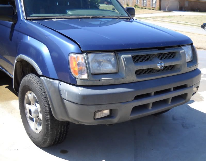

So I spend a lot of time on the road for my job with a lot of downtime in hotels. One evening I grew tired of the usual forums I frequent and went in search of some new forums to lurk around at. I ended up here and have spent 100’s of hours soaking in all the knowledge I could and coming up with a plan to resurrect my X and rectify all the maintenance I have ignored over the last 10 years and 160,000 miles.
As it was when I started.

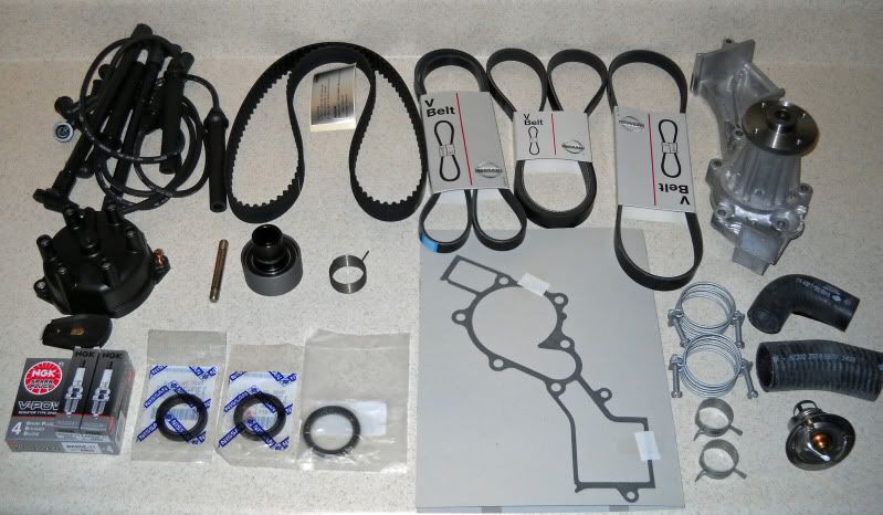

The first priority was to get current on the maintenance I had been neglecting. I re-packed the front wheel bearings and replaced the seals. Next I changed the fluids in the front/rear diffs, transfer case, and transmission and then learned that I was a mere 55,000 miles over the timing belt change interval. So parts were ordered and I waited nervously for the timing belt to snap while waiting for a free weekend to get it done.
75147
To say the timing belt was overdue for replacement is an understatement. With absolutely no effort you could deflect the belt about 45mm…….. sweet variable cam timing! :LOL:;) Basically the belt was stretched to the point that it was 15mm longer than the new one.

With the basic maintenance issues mostly cleared up I moved on to fixing all the faded trim. If any one project lit the mod fire more than anything it was this one. I stood back and looked at my X after I was done and low and behold there was the truck I loved beginning to creep back from the land of the grocery getter.
The things you find when removing trim….
Generally not a good idea to lean the parts you have drying after sanding and washing against the wife’s Murano, especially if she catches you doing it. Bad idea.
After the painting….
