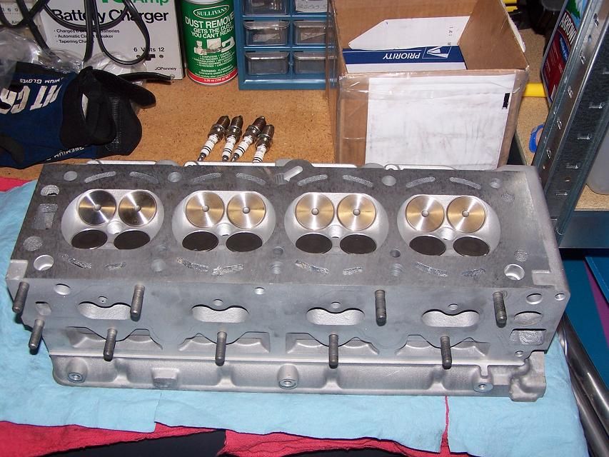

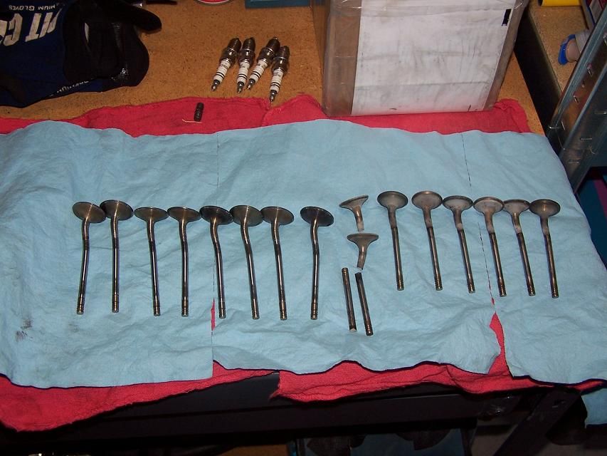

In case anybody cares. Here are pics of my girlfriends Isuzu Rodeo when the tensioner snapped. Interference fit engine and it bent EVERY valve. You can see none of them would close while still in the head. Don't risk it. Change those belts and associated parts.
BEFORE Head Repair
AFTER
The after looks better.
