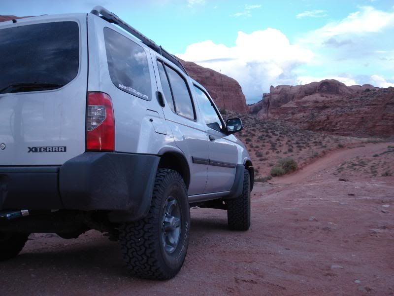

Pics
Stock
August 2009
Sept 12th 2008 (Moab trip)
