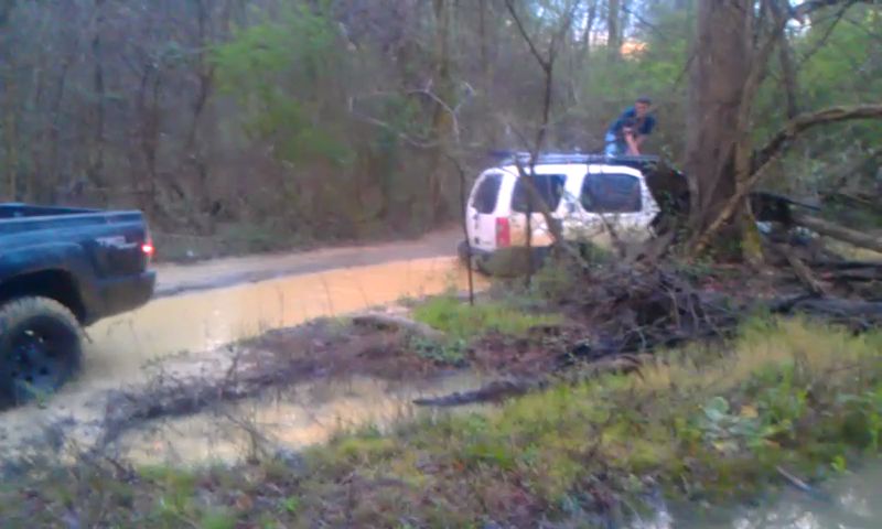

well I figured i'd post this fail since my buddies have yet to let me live it down
The tacoma you see pulling me out in this video has a locker, and a set of cooper discover stt mud-terrains and refused to try it.
There was another tacoma with us that day, locker, 33s, lifted and refused to try it also
