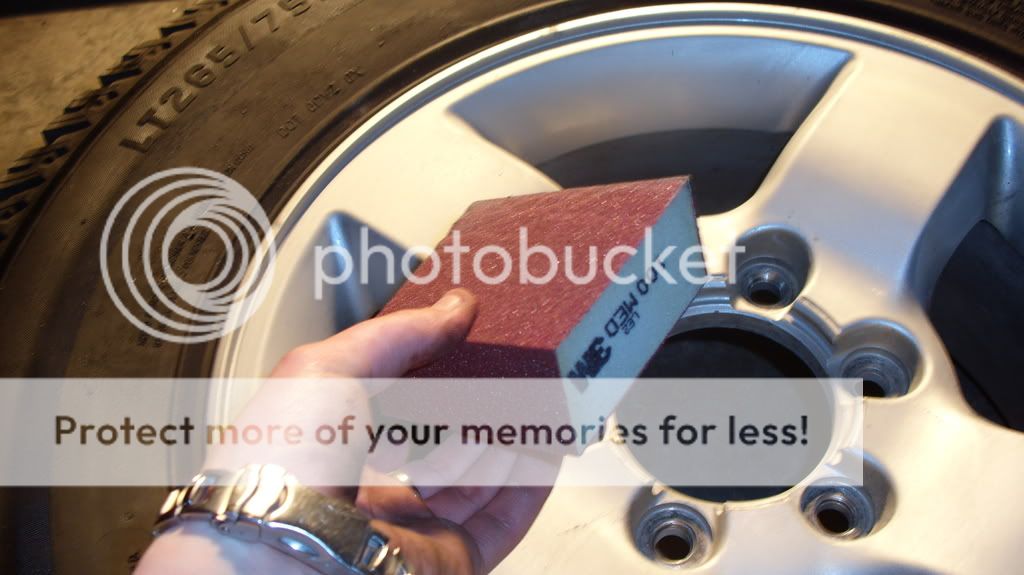

---Sand paper- 100 - 300 Grit sandpaper, I would get the block shown in the pic, I only used one.

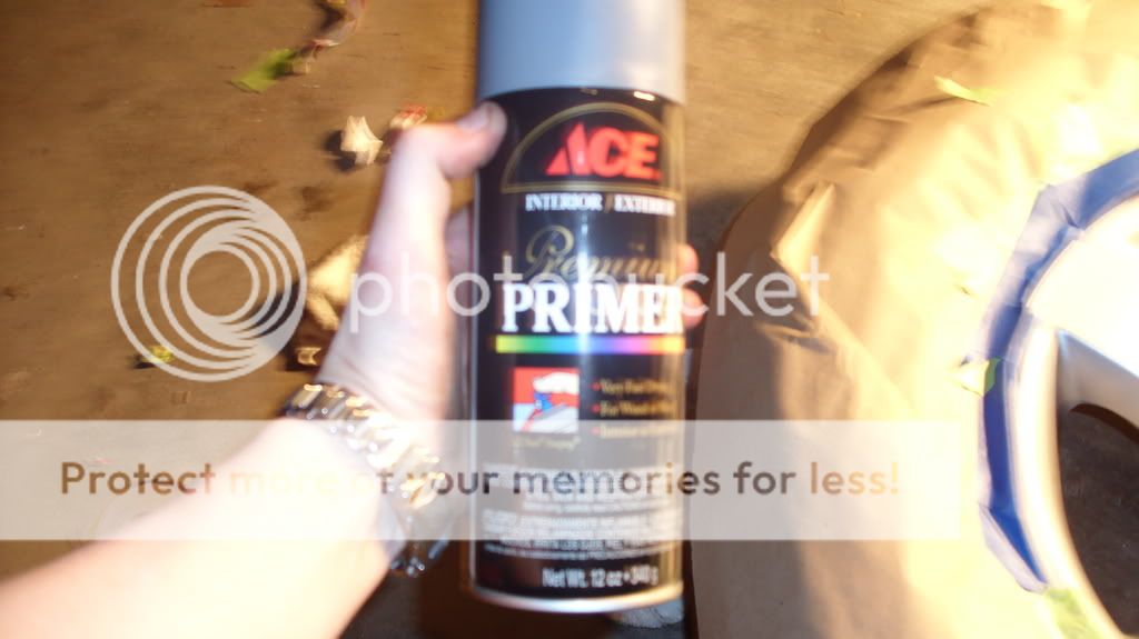

---Automotive primer (2 cans should do the trick)

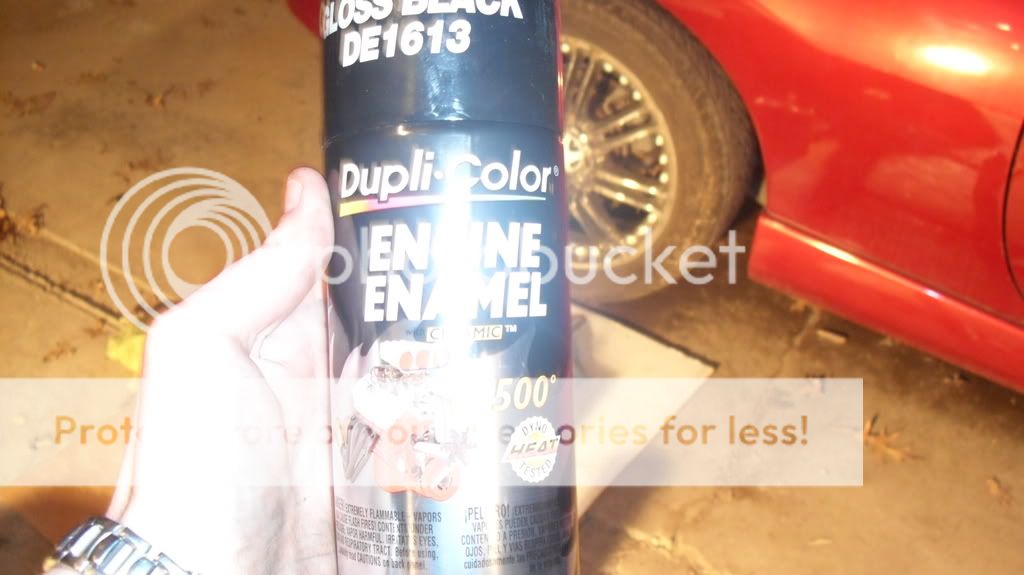

---2 Cans of paint. (VHT polyurethane wheel paint is the BEST, but very hard to come by. I used the Duplicolor high heat engine paint with ceramic.)

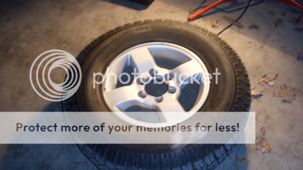

First off... take the tires off....

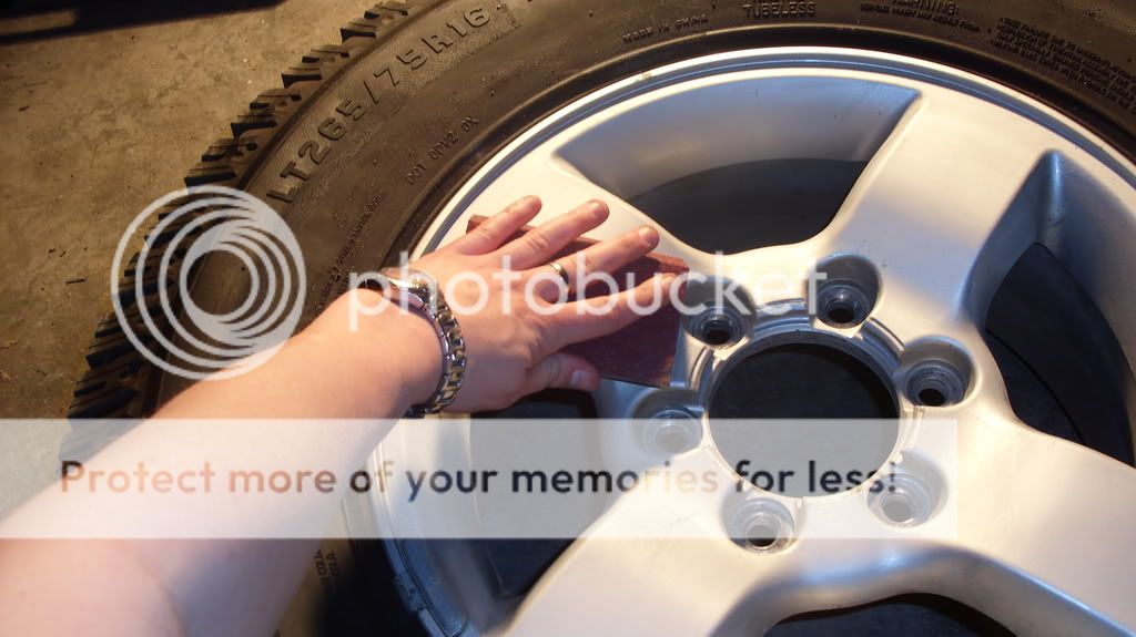

Grab your sand paper and sand away!

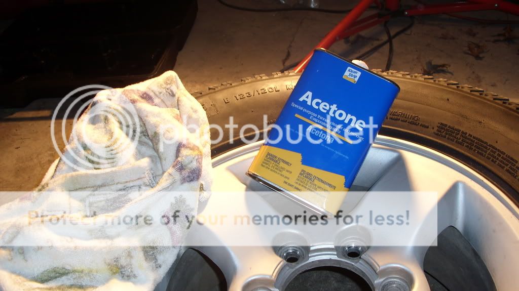

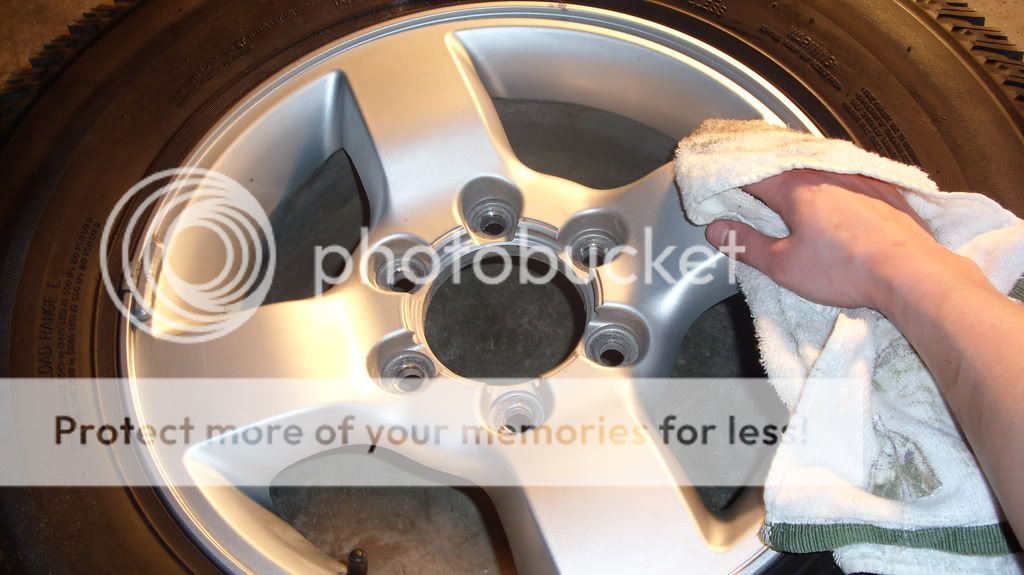

Once its all sanded down and smooth, grab your paint thinner or acetone, along with a clean rag and wipe the rim off.

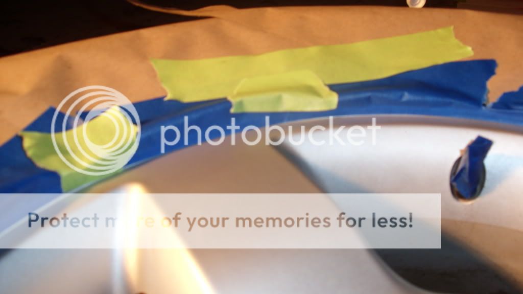

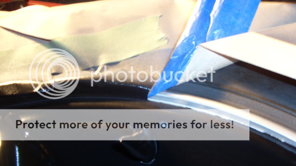

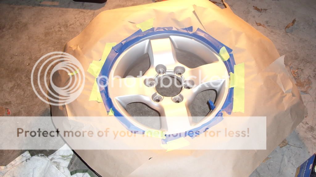

After the rim is cleaned, tape off any part of the rim that you do not want paint on, then lay your paper or plastic down to avoid getting the tire painted.

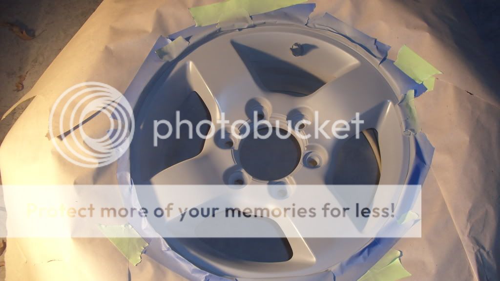

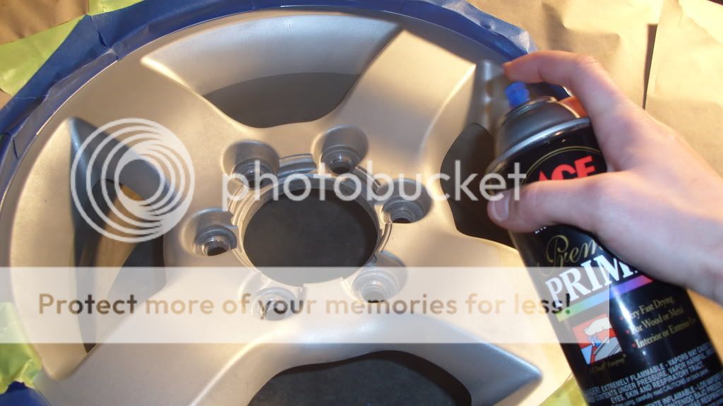

Once your done with that, coat your rim down with a couple coats of primer.

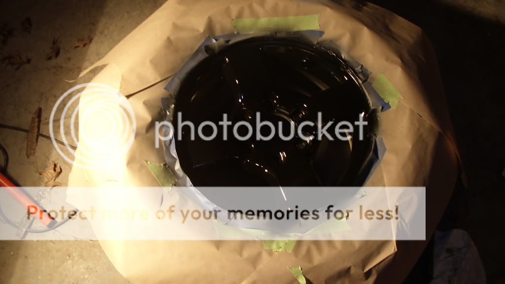

Then your ready for paint! I put several coats on my rims.... =) Just incase..
Give it time to dry before you peel the tape off. I normally pull the tape off at a 90 degree angle... breaks the paint from the rim to the tape...

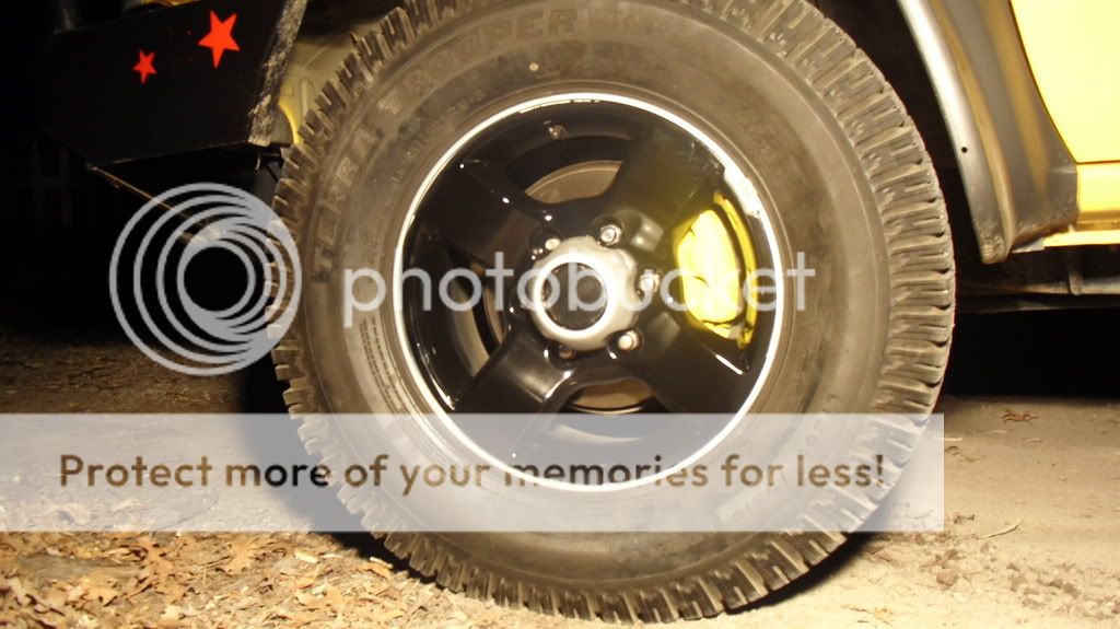

Then your done!

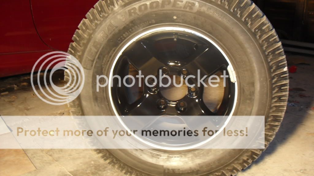

Very nice chantale! I like the clean glossy looks have you thought about putting a clear coat on to keep it nice and glossy? I know that engine enamel hold up pretty good but just to be a little more on the safe side if you want the gloss.

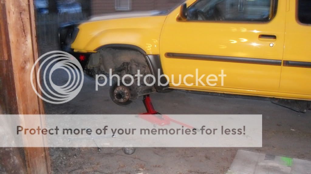

Thanks everyone, and Stevin is right, use some jack stands, just in case...

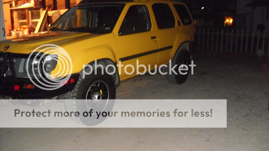

Thanks for the write up Chantale. I have been thinking of doing it, but wasn't sure if I'd have to remove tires from rims. I guess the tape trick works pretty good.
And, your X looks even better now!
I did clear coat the crap out of my wheels. I put several coats on just in case. They are still really really shiney!! haha :wink-big:
