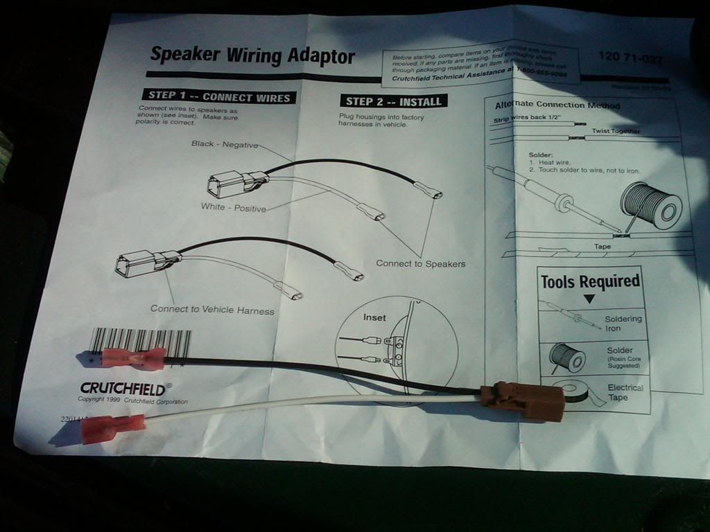

Step one: Copy and print the installation sheet (image) below. I received the instructions from Crutchfield

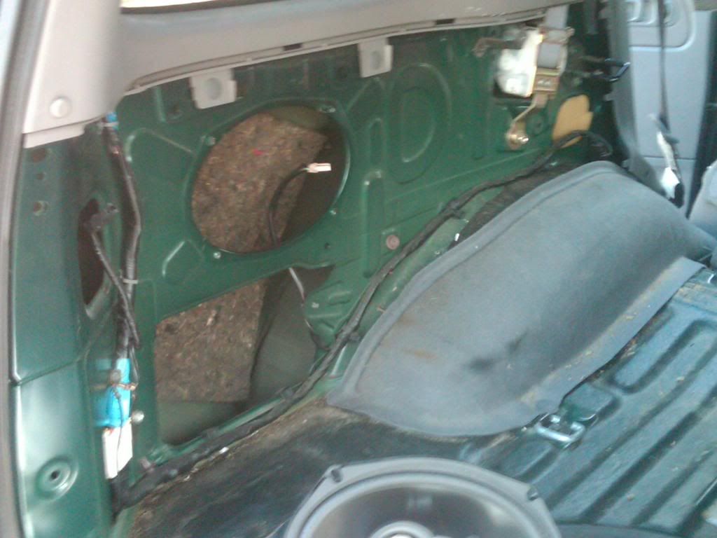

Food for thought; Use a flathead screwdriver and your hands to remove the plastic panels & DO NOT forget to remove the Phillips screw where the cargo cover hanger is located, as well as the plastic retaining clips which should be removed carefully.
Here are pictures I took of my progress.
Panel removed:

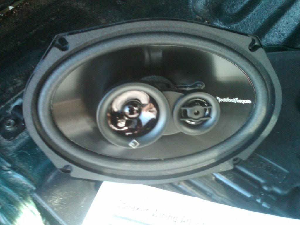

6" x 9" Speaker I used:

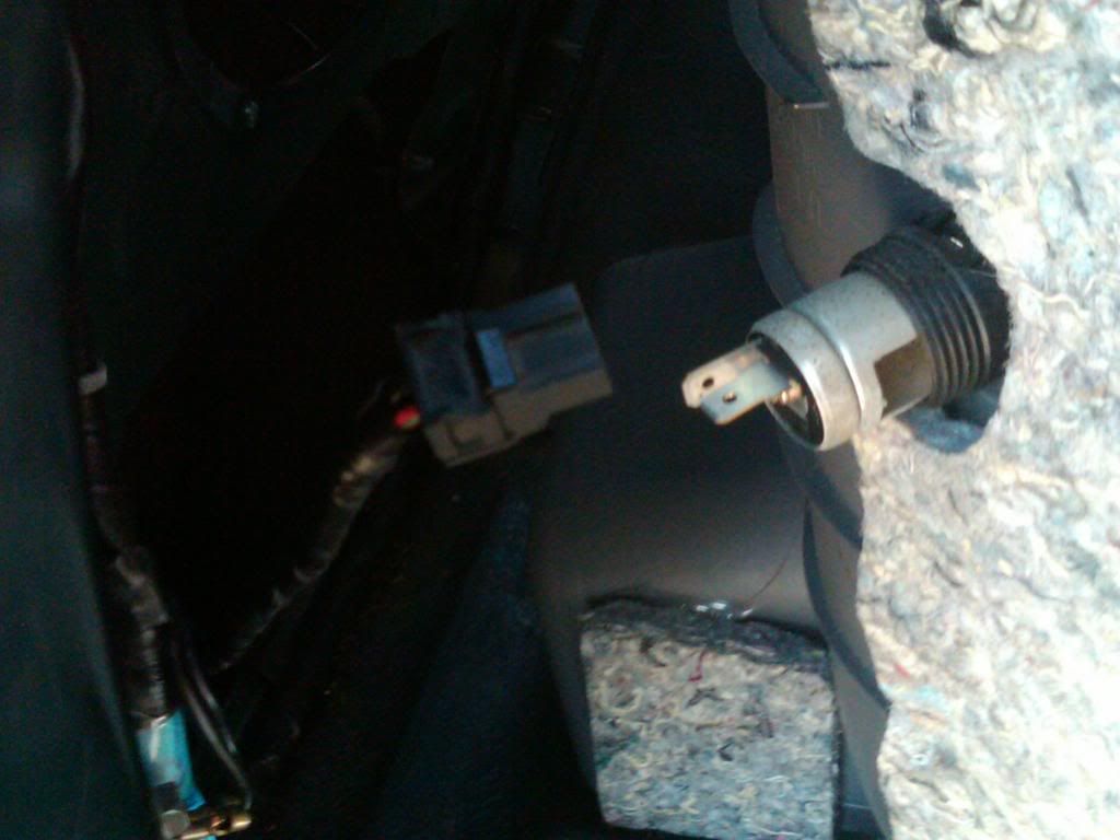

12V power supply connections:
12V power supply connection closeup:
Speaker wire adapter & instructions that Crutchfield will supply to you WHEN asked for:

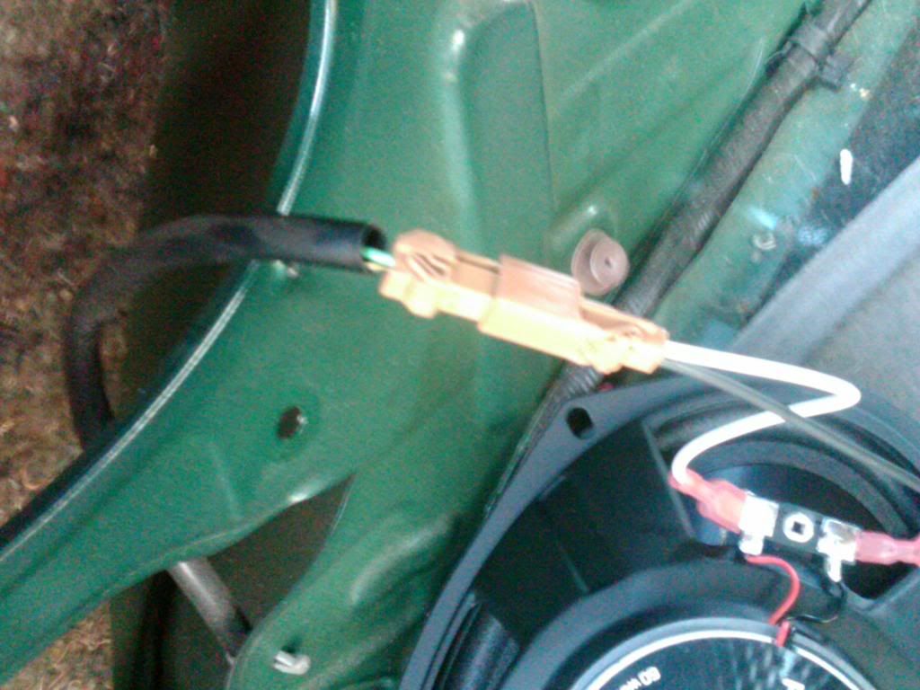

Speaker wire adapter partially* attached to the OEM wiring
*I showed the connections partially attached to show a clarity between the OEM wire connection & the wire adapter connection
Also note the wire adapter connections to the speaker itself.

Just pay real close attention to the depth of the speaker because i know first hand there are a lot that don't fit. And the wall behind it is your sheet metal so theres little room to give.
yeah, i was figuring i'd have to fab something up to give it alittle more room, I just never thought about putting a sub there, i hate the idea of losing cargo space
#11 ·
Not that, i mean the 6x9's. I went through 3 sets before i got some that fit. First were just plain too deep. 2nd were right there but when bass would hit the metal would rattle against the back of the speaker. 3rd i got a foam baffle, put it in then used some small plastic washers to space it out a bit and the tweeters just miss the grille.

the power outlet clip can be hard to remove.. Dont use a screwdriver to try n pry it out. You'll blow the fuse. Need to have a 2nd set of hands

just a quick FYI too, on the 1st gens you don't need to take the panel the whole way out. pop up the trim along the hatch "hook", pull out the pin on the lower right interior panel (near the top along hatch opening.. it's one of those pin inside of "clip" deals so you pull the middle part and it will come out), undo the screw where the rear cover mounts as this will give you a bit more room without the pressure. pull panel out and you'll have enough room to get a ratchet + 8mm in there to unbolt factory speakers and mount new ones. The only way this won't work is if the screw holes for the new 6x9's are too far off and you have to tap holes in the sheet metal, then you'll have to completely remove to make enough room to work.

I can't believe the factory 6x9s are only rated at 50w max, most modern aftermarket head units will quickly top them out. I pulled my panels completely out and covered all the metal with sound deadening, for a little better SQ. I also had to clip and re-connect the wire for the rear power outlet because that damn plug just wouldn't give up it's death grip. I hate cutting wires but you gotta do what you gotta do.

If you don't get the adapters for the speakers from Crutchfield, all you have to do is cut off the plastic connector on the end and wire them up. Black is the ground. You can splice small sections of speaker wire in if you can't get enough slack out of the stock wires.
