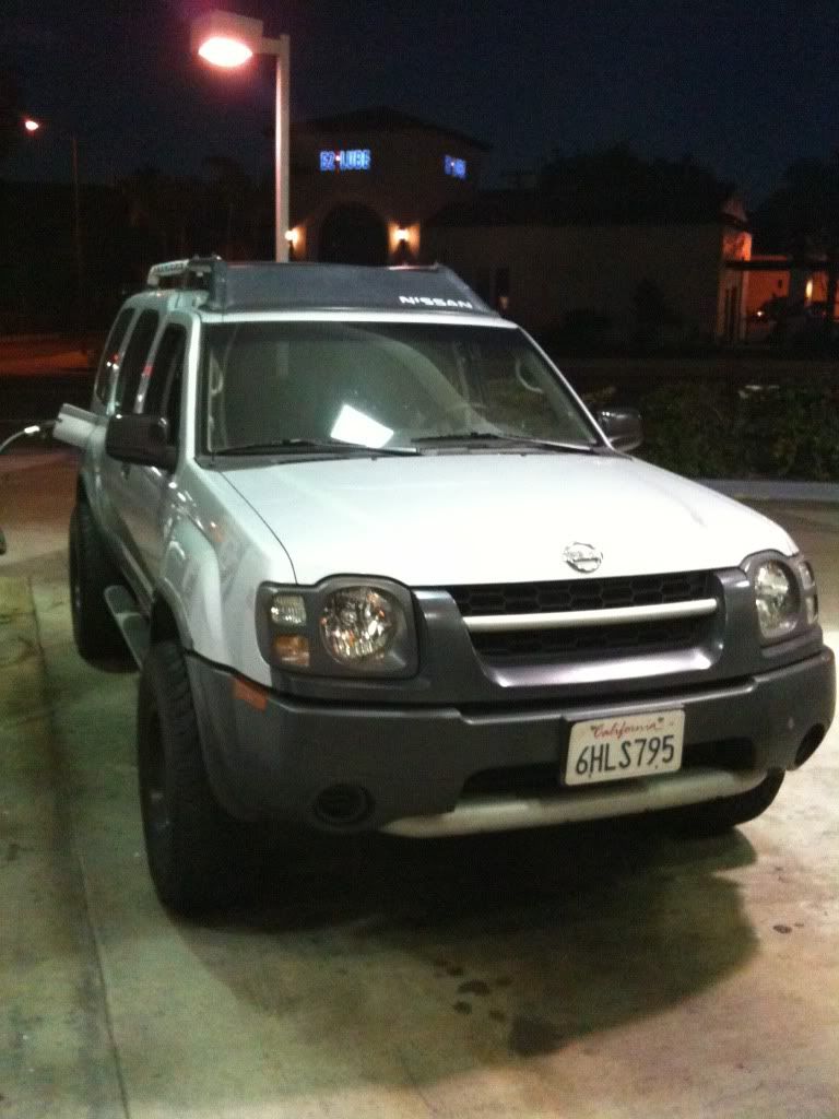

the very next day, i realized that while the guy had kept it in good shape, he neglected things like tire pressure. I was 35psi front left and rear right, 38 rear left and 24 front right.
Current Photo:

Jeez did this have a lot in store for me. The actual lift went very smooth. Didn't need to trim around the t-case shifter or anything. the rear bumper gave me some trouble but that was about it. within the next 3 days i broke my heater core and radiator. $108 and a new S/C radiator later, my heater core still needs fixing but she's running strong.
