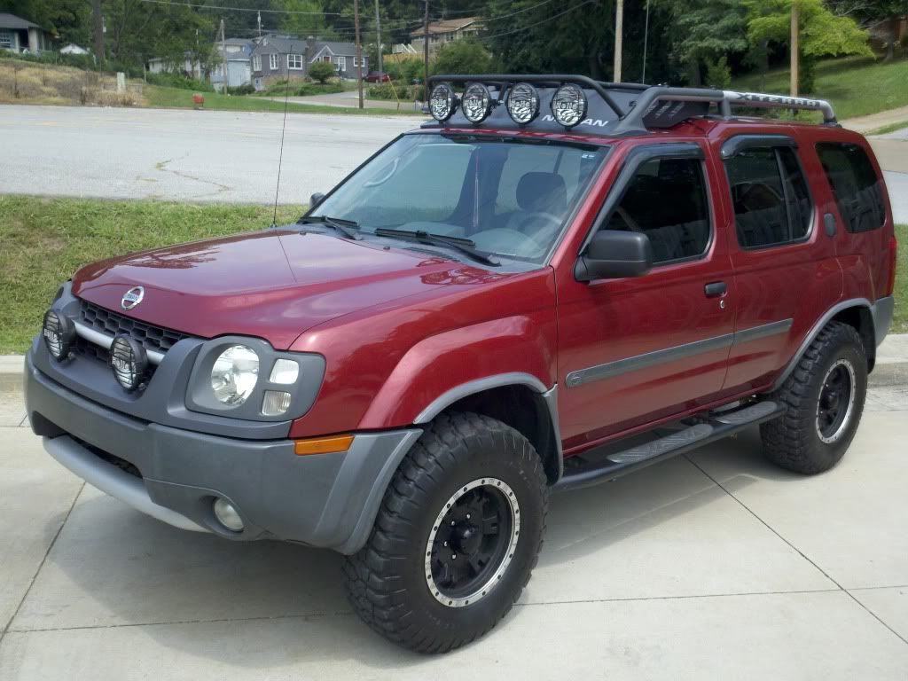

I generally try not to do parking lot pictures but my Xoskel light cage came in and I had to sneak out the back door at work and install it along with the lights. It's not wired yet but once I unpacked it and saw how easy it would be to put it on, I just couldn't put it back in the box and toss it in the back to haul it home.
You have one of the best looking 1.5 gens that I have ever seen. Now all you need is some sliders before coal creek
hey man don't feel bad about about the light bar.. Doesn't bother me at all..
I was going to buy a Xoskel.. just couldn't pay the price.. So that's why I came up with my own.
So are you thinking about a Bodylift? If so let me know..
We can get some guys to help
Thanks Ryan. I have sliders on order...since April 11'th. I don't think it's unreasonable to hope they come in before Coal Creek.

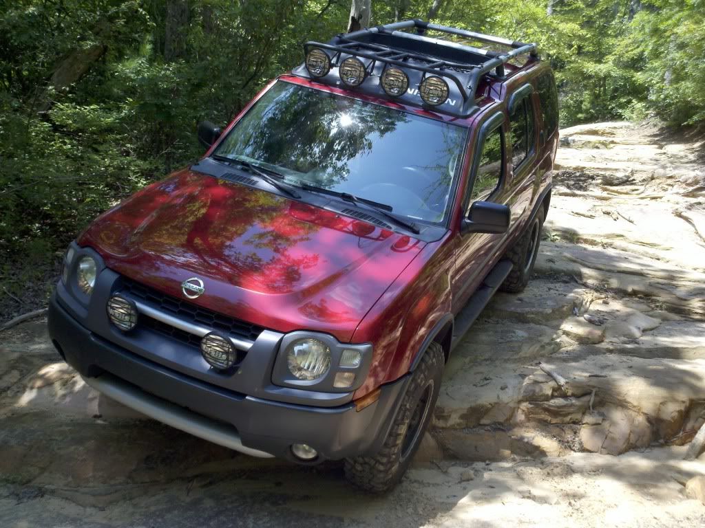

I want to do a suspention lift. I'll probably go with the AC articulator kit. I haven't decided if I'll try to tackle that myself or have a shop do it but it's not likely to be real soon. The DIY here makes it look like something I'd like to try.
You can get a better look at the light cage from this angle, plus it was a lot more fun than the parking lot at work. I managed to do a minor rock assisted mod to the passenger side step bar later in the day so now I'm really hoping my sliders show up soon.
Looking good! Keep up the work. I think your X is my favorite "stock X"!
Nice X, love how those rims and tires go with the rest of the X
Thanks guys. I really appreciate your kind comments.
Aaron, that means a lot to me. There are so many sweet "stock Xs" so to be anywhere near the top of your list is awesome!
Aali, thanks for noticing. When it comes to performance or appearance I try to consider the total package, not just the individual part or parts. I've learned the hard way that combining great parts doesn't always give you a great end result if the parts aren't designed to work together. Of course, I still end up doing something that causes me to want or need to change other things as well on a regular basis. Mods are like chips, you can't have just one.
:hypnose-big:
All i have to say is 'agreed' lol
The X looks really good! The black rims look good against the burgundy of the X. She coming along nicely!
Nice X! I love those wheels!!
Nice looking x love the wheels! the light bar looks great too, really makes me want one.
Very nice X !! Love the top light set up, awsome wheels as well !!
Great lookin' X, man! Out of curiosity, what size tires are you running?
