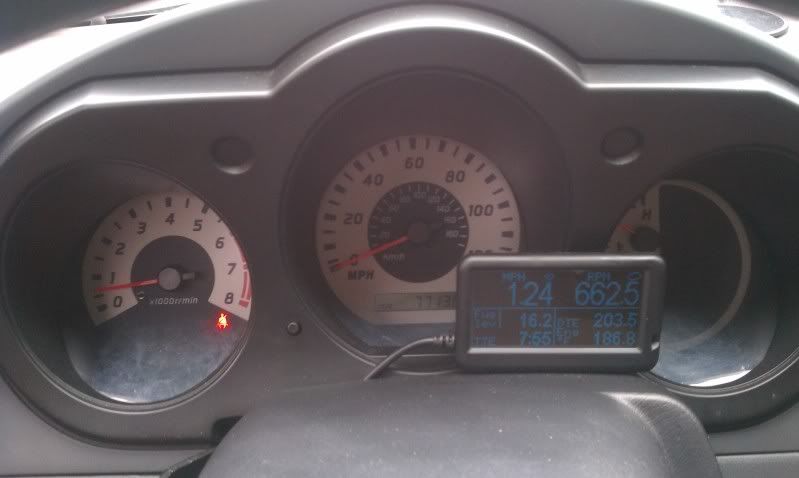

Basically what the unit does is it plug right into your OBD II port on your X and that's how it is powered/ reads the ECU. You can set it to whatever settings you prefer and go from there. It alerts you if you have a code or CEL is thrown, and tells you what the code is. Also you can clear the code with the ultra gauge unit.
Install was simple, best spot for me was by my speedo, I used heavy double stick velcro, ran the wire down the steering column and into the OBD II port.. it also comes with a windshield suction mount you can use as well, I just wanted it by my speedo.
The screen is fully customizable
Mine is set up with: Instant MPH, RPMS, Fuel level in tank, distance to empty, time until empty and the Engine temperature
If you're looking for a handy tool then I would highly recommend this. It turns on and off with the X via the OBD II connection and is nearly instant.
Well worth the money to fully read everything that is going on with my X.
