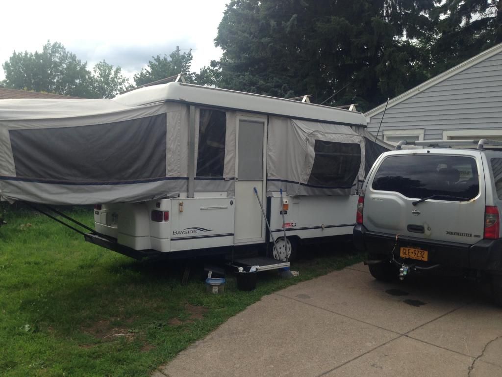

I have a 2014 Jayflight swift 154bh that has a GVWR of 3200 lbs and a dry tongue weight of 290 lbs. I use a sway bar but no type of weight distribution system. I do notice I have a nose high attitude when towing and often have semi trucks flashing their lights at me thinking I have my high beams on. And at highway speed I'm very limited on power. I have a manual transmission and am typically in 5th gear when cruising and downshift to 4th or even 3rd to make it up grades all while averaging 10 mpg. Am I overworking my 2015 Xterra or is it made for this kind of work? A recent 800 mile trip made me rethink my decision to tow with an X, but I might be overreacting.

I would consider trailer brakes, maybe a load distribution hitch. But I have towed far more in my gen1 which has a much lower rating and 1/2. The power you should be fine
this is what i tow
not sure what its weighted in at.
but to be fair i had towed it with a jetta before i got the X
