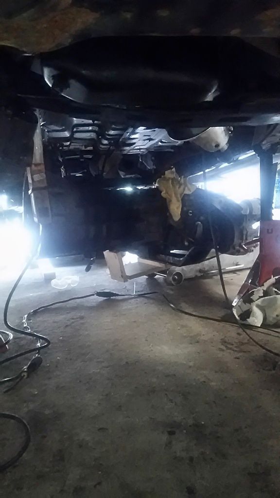

Why does everyone hate pulling the tranny off and putting it back on while it's on the vehicle? it's not that hard. Me and my dad did it with two jackstands and our backs. We put a jack with a screwed in plank to hold the tranny in place. No vehicle lift. This was on a manual tranny as well. took 10 minutes to put it back in after everything was ready. look at this pic.

Same here...used a low jack the same way...its not that bad.
