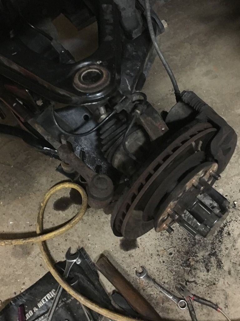

I bought this 2001 xterra with 215,000 miles on it earlier this year. After someone totaled my Jeep WJ. Scored this X for a deal at a local dealership. I started my journey by ordering 33's and 5 inches of lift. UCAs from 4x4parts as well as their IDB and adjustable shackles, pieced together the 2 inch body lift. Cleaned out my dads shop and pulled it in. Started with the UCAs, removed old ones. Easier said than done, driver side one of the camber bolts was seized in there, after 2 hours and a sawzall she was out.
Here is the aftermath.

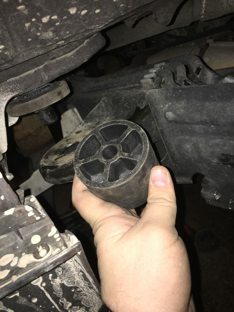

Installing pucks - anyone else have to remove those sleeves for everything to fit? Only like 6 and different style sleeves but they had to come out not sure why no one else ever mentions these in their tutorials
Don't lose these and remember where they went because some of them are different
