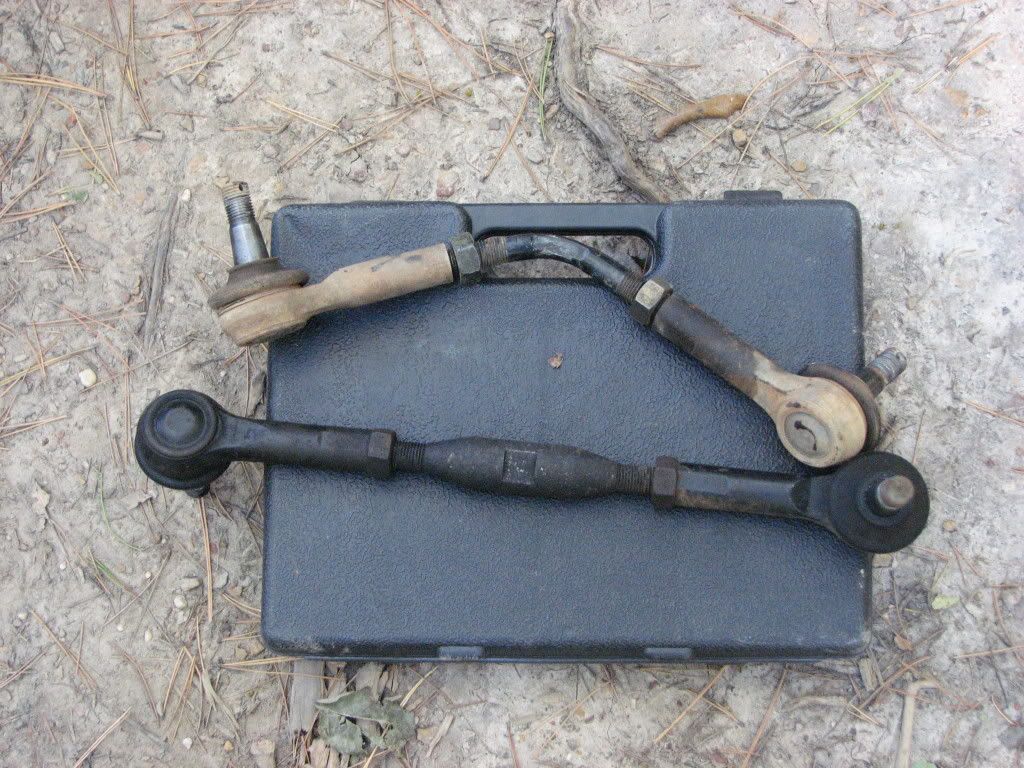

And here's my passenger-side TRA after attempting "Thrill Hill". Prime example of what can happen with too much traction and a weak steering system.
The old one next to my trail spare which I should've had on in the first place because it's a calmini assembly.

So from the way it sounds, the TRA was due to the stress of the bigger tires???
More or less. My tires were getting so much grip and the pathetic stock TRA's couldn't handle the strain and just folded. When my front-end would start bouncing, the tires would spin freely for just a second and then when they hit the ground again, they gripped and the TRA's couldn't withstand the stress.
I only had one trail spare which meant I had to try and fix one of the two I bent. I should have taken pictures on how I did it but for all the times I cussed my trailer hitch, it saved me at the end of the day. I took the TRA and ran it through the locking pin hole in the receiver then put a nut on the otherside to hold it in place. Then took a handle from a hi-lift jack and slipped it over the other end of the TRA (using two extra nuts I had to protect the threads) and straightened it out. It wasn't perfect but it gave me a straight"er" TRA that I knew would at least get me back home.
