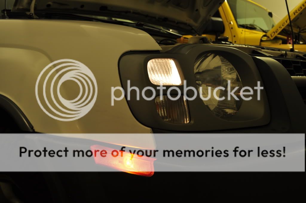

First let me show you the stock stuff!
As you can see the top light is almost white, no amber and I just don't like it... I want the top one to match my side marker light!

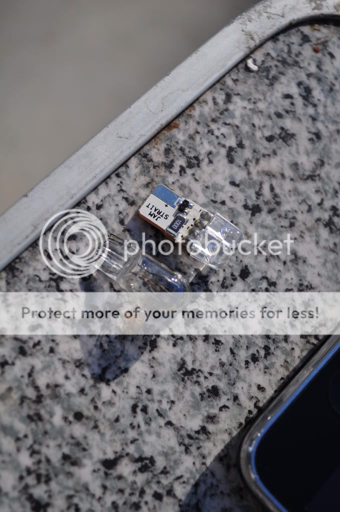

Now this is what we will replace them with! 194 LED's that I picked up from my local O'Reilly store for about $9.00 (Note: '00 to '01 Xterra's can do the same thing but just need to unscrew the top of the side lights and just pull out... The rest of this guide is for the '02 to '04)

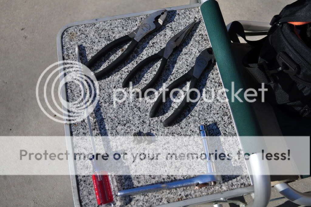

Alright lets begin, first the tools! 16x9 Long flathead screw driver, pliers needle or normal(I have 2 and ***** because I was working on other stuff too), and a 10mm Socket.

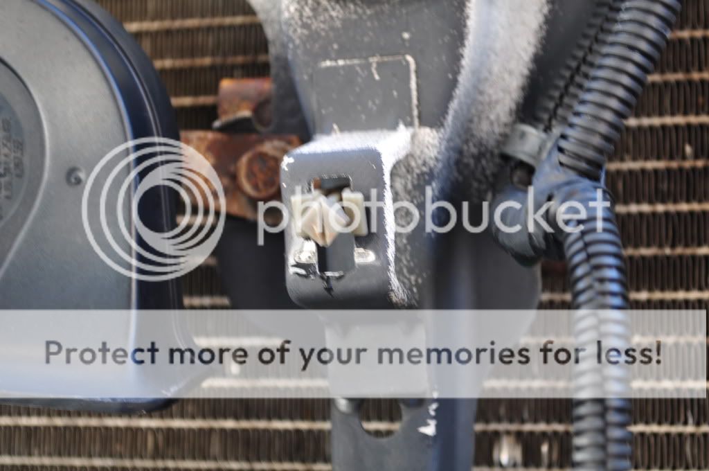

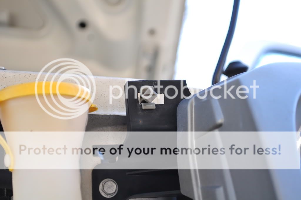

The goal is turn and pull all of these little clips so you can remove the grille without taking the bumper off! There are 4 located along the top and 2 under each light and 1 in the very middle (which is the toughest to get!)
The clips look like this once removed
Once you turn the clips be careful to not turn them to far because they are just plastic and will break you just need to turn them so the squares line up on the grille and be pulled away from the engine bay. Leave the clips in the spots so you don't lose them and then gather them up later putting them back in is the hard part!

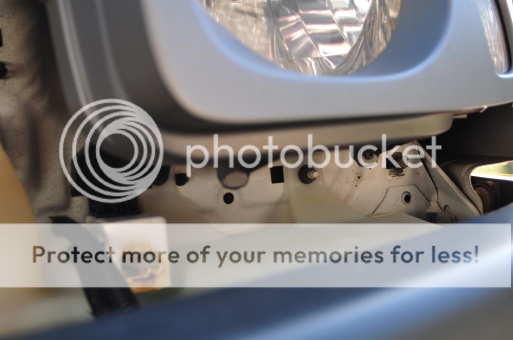

Here is the two under the light, one on the left hand side and one on the far right.
The middle one is the hardest and will take the most patience and maybe a friend with a flash light so you can see if your turning it. If you have a license plate holder attached to your bumper remove it so you can reach easier and get a better angle.

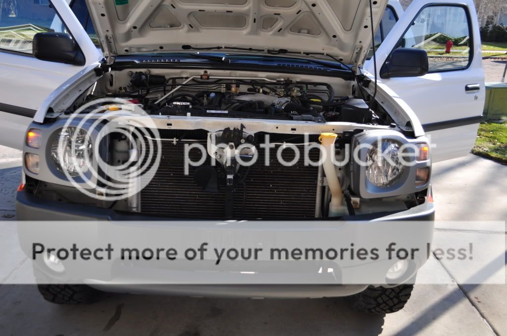

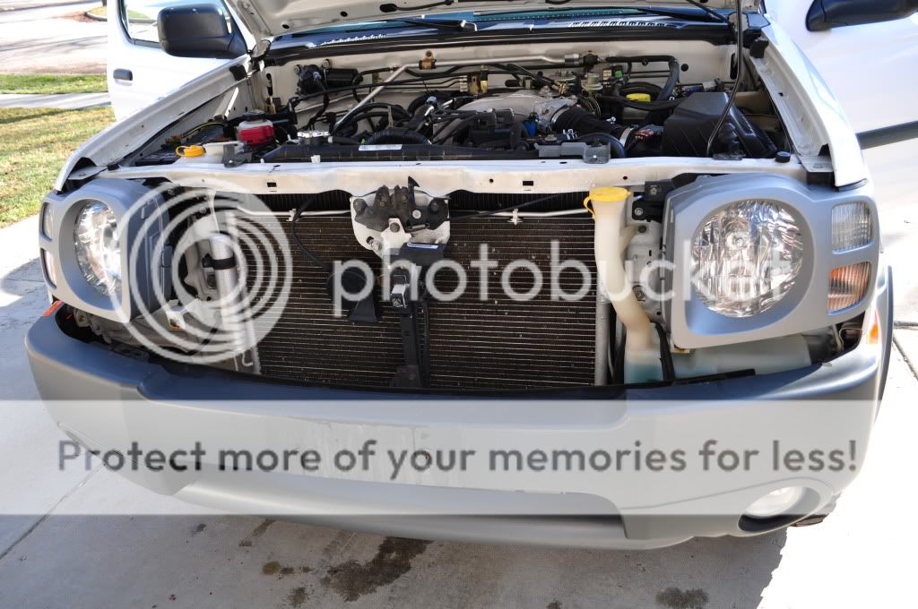

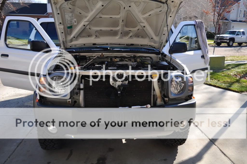

End result, the terminator
Next remove the 2x 10 mm screws one on the top and one on the inside... Not pictures sorry, it's self explainatory

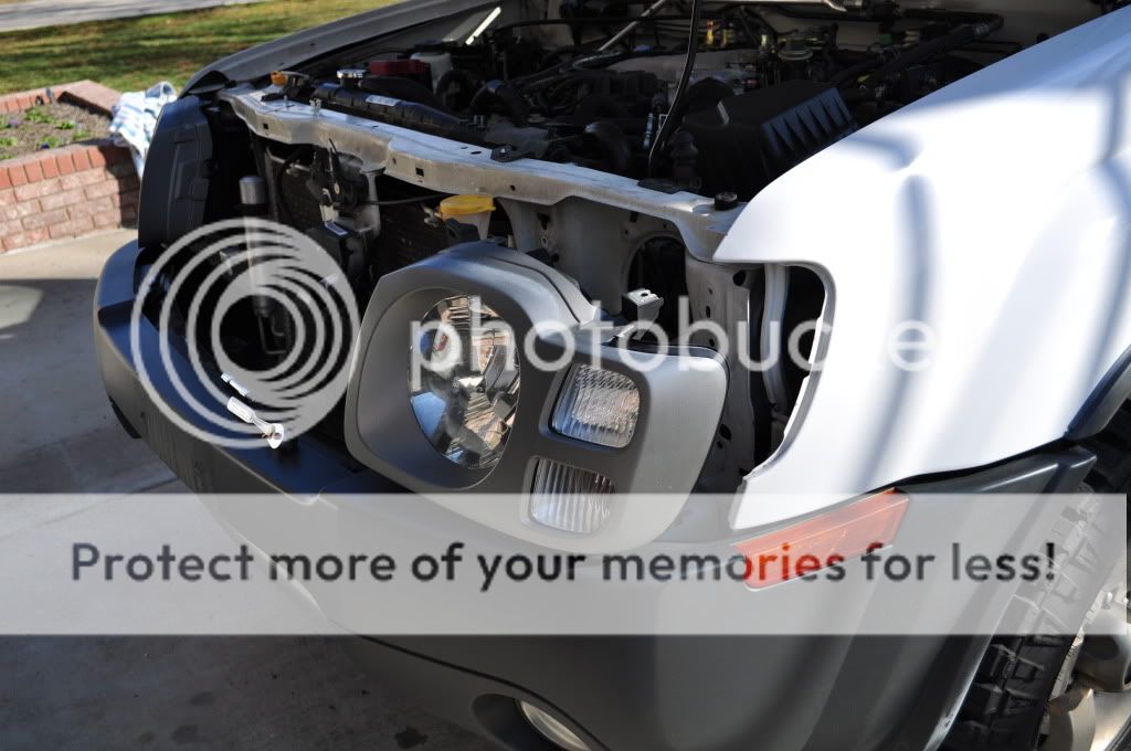

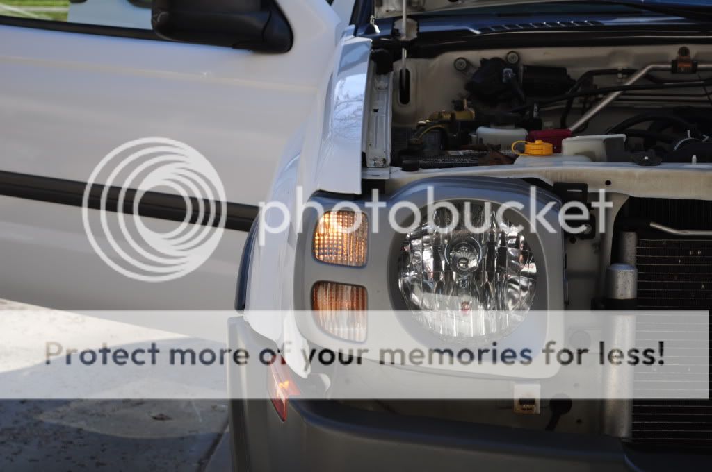

Now tug on the light towards you and it will pop out, reach behind to find the upper light...
Side by side comparison of the two!

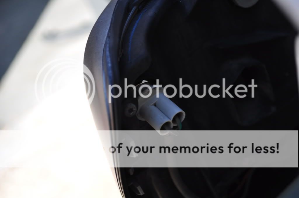

*** For those of you wondering why not do this to the turn signal.... DON'T! Turn signals on our xterra's use resistance to work and LED's do not, you need an LED turn signal fixer thingy (can't remember the name) in between the wire and the light. I will do a write up on that down the road! ***

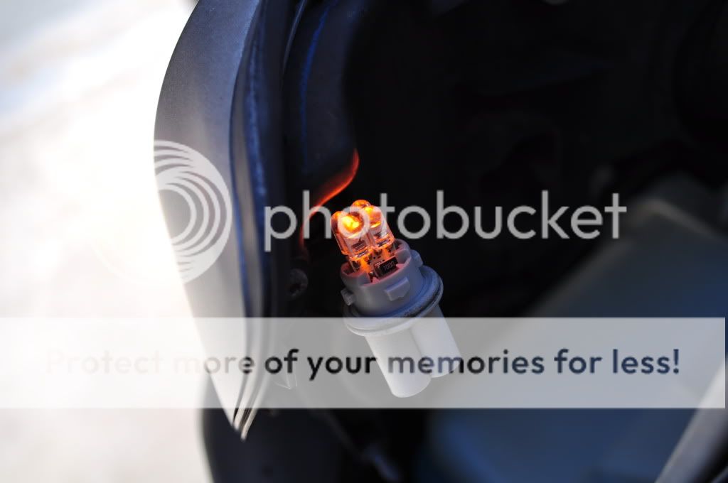

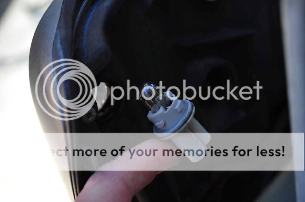

Alright so pull out the bulb and insert new LED, don't worry they are not one direction or another just insert them!

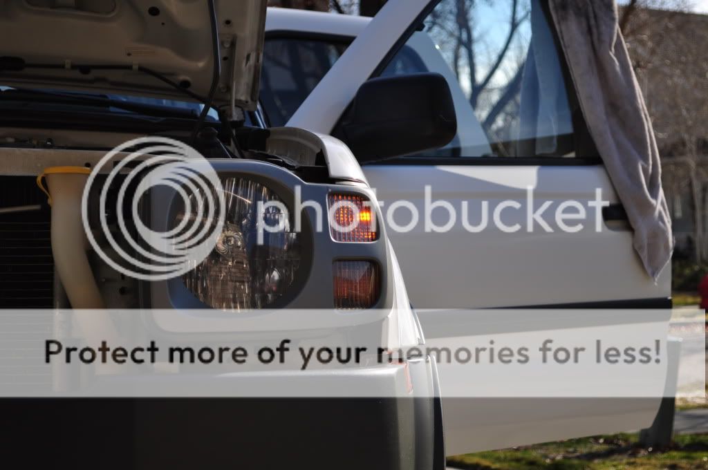

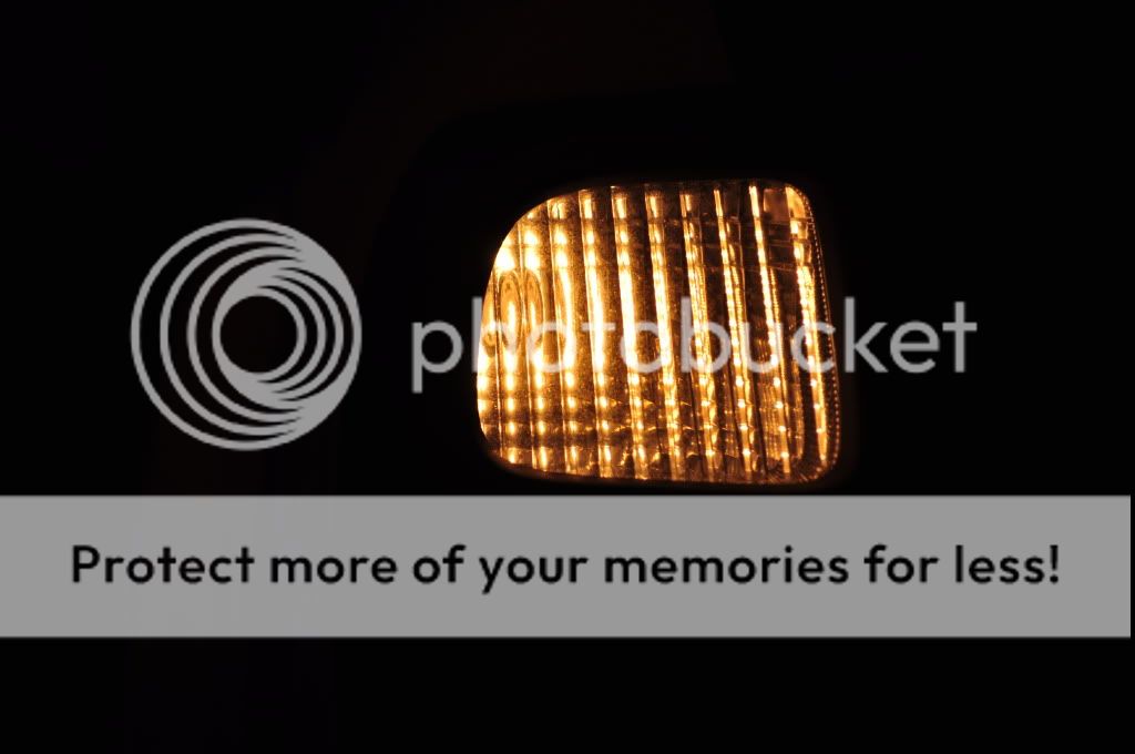

Here's what you should end up with! Doesn't look bright but it is! That's because the light is focused more and once in the dark it's much more apparent!
Again here's a before...
Comparison in daytime
Both done!
Final product!

Alright night time shots!
Sorry I do not have any night time of before, I was dumb when I started this!
