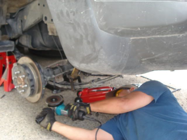

Greg's instructions are a little vague because they are written for Titan, Frontier and Xterra, so there are a few things that didn't apply to the Xterra, but one thing was spot-on, step 11 of his instructions specifically sez it "may take some aligning and cuss words". However, he forgot to mention the skinned knuckles. Here's me cutting the aligning bolt that came with my Deaver leaf pack. Greg mentioned I shouldn't over-tighten that bolt lest I strip it. Well...... I definitely over-tightened it. Way, way too much. Good thing it's only there to line things up...
