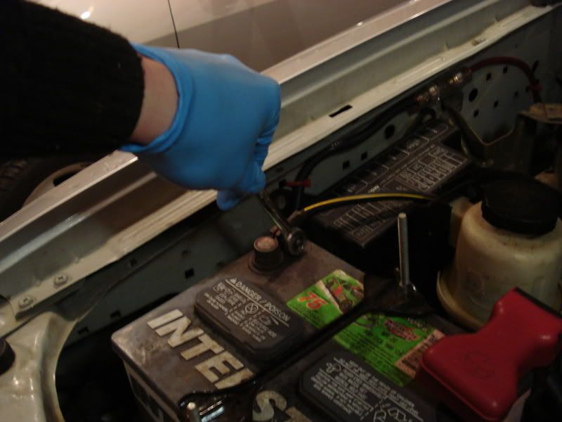

1. Remove negative battery cable from the negative battery terminal. Important: Failure to do so could cause arcing, lighting your hair on fire, cursing and blowing of the fuse-able links so just do it.

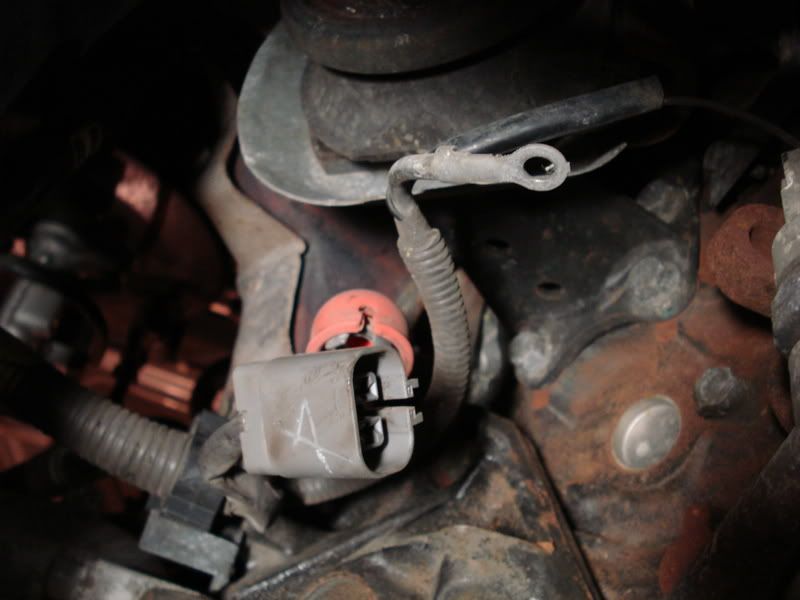

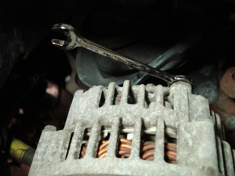

3. Remove red terminal on alternator from above. Its a stud coming out of the alternator hold the boot back use a 12mm wrench to remove the nut and terminal.
4. Remove the ground terminal I used a shorty 10mm wrench as the area was pretty tight.

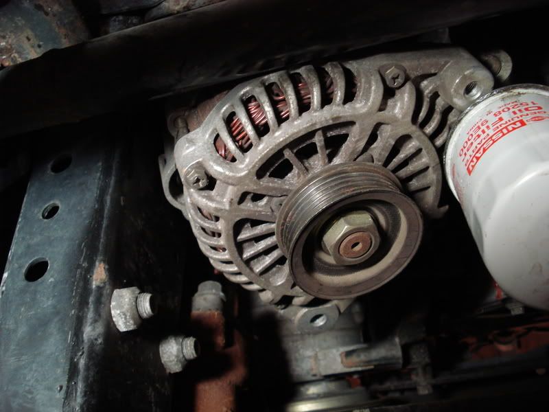

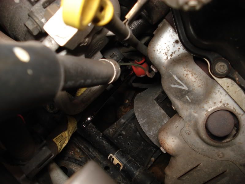

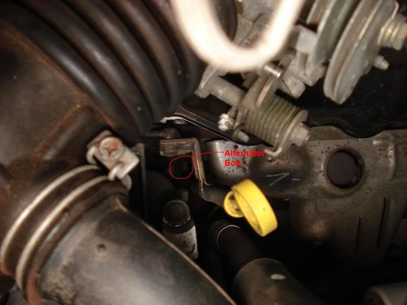

5. See that red circle in this picture, that is the alternator bolt. Reach around down there for the top of the alternator and remove the upper bolt that holds the alternator on.

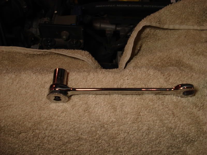

This is the wrench I used in the above photo though a normal ratchet and socket will probably do the job equally as well. It's tight so I preferred my Gear wrenches high engagement. It's a gear wrench with a 3/8 adapter and a 12mm socket if you must know.

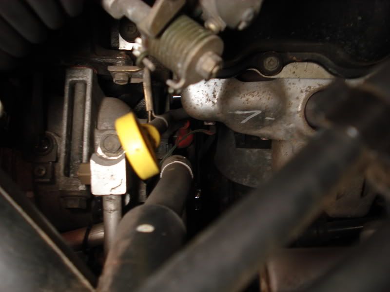

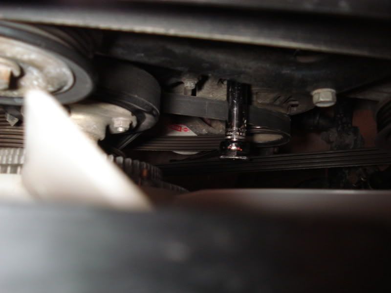

6. Remove the front bolt near the fan. I found the best way was from the bottom. Deep well 12mm socket is what I used. Possibly a normal socket with extension and a ratchet would have been the better tool for the job.
7. Completely remove the lower bolt from the bracket.
8.The alternator is now loose, rotate it around until you can get a good pinch on the signal wire connector's release tab to work it loose.

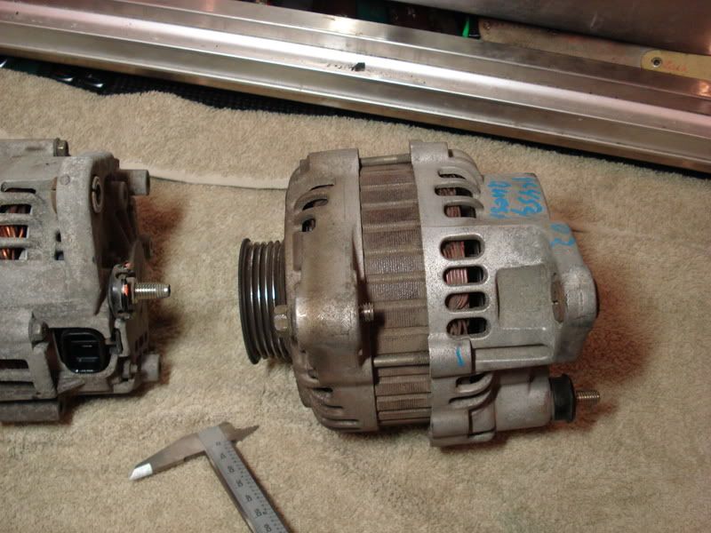

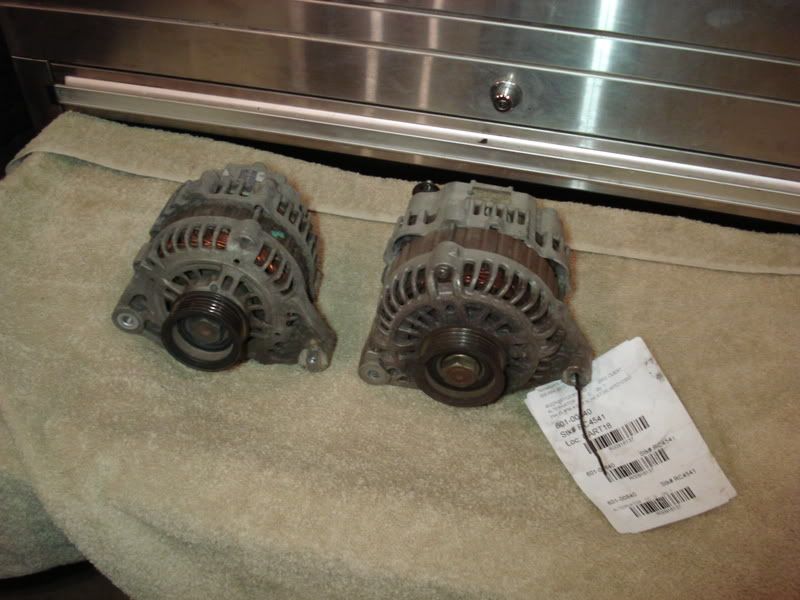

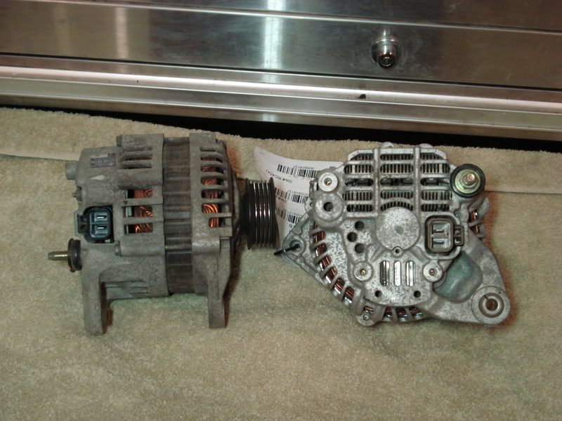

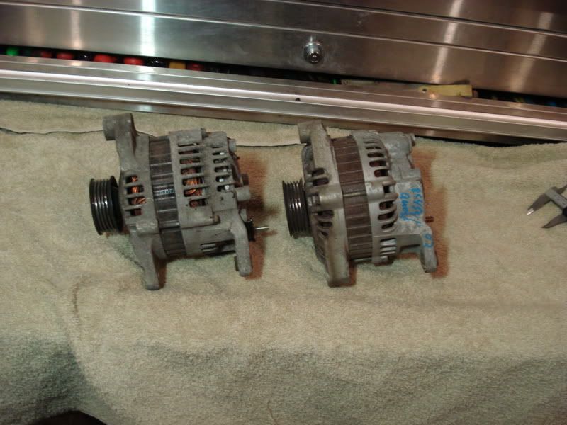

10. HA! halfway there. Compare your alternators, Quest on the right.
As you can see the Quest is a little larger and the mounts are in the same places.
The connectors are the same though they are not in the same locations.

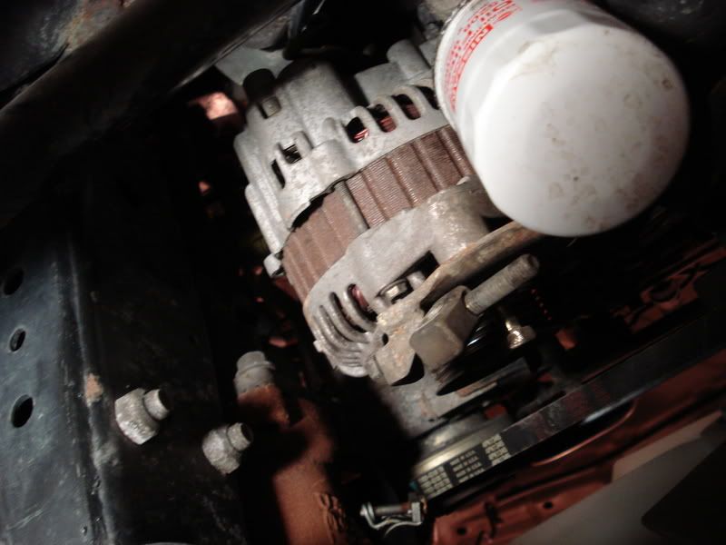

The Quest has more beef on the upper mount this is where a longer bolt is a reasonable option. I found one out of my drawer that was just a hair longer. Though you could still use the stock bolt.

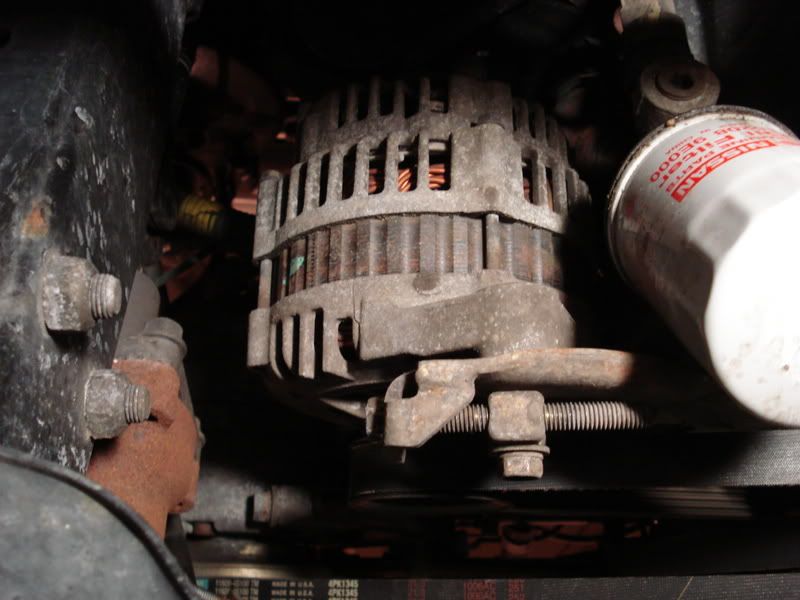

Stock
Quest with stock bolt.

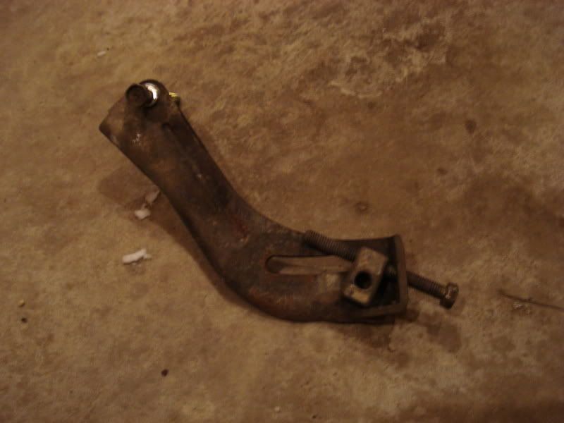

11. I would recommend shaving or grinding this area flat a bit as it is very hard to get the belt over the pulley without grinding here as the alternator bottoms out on the oil filter mount.
Another angle of the trim.

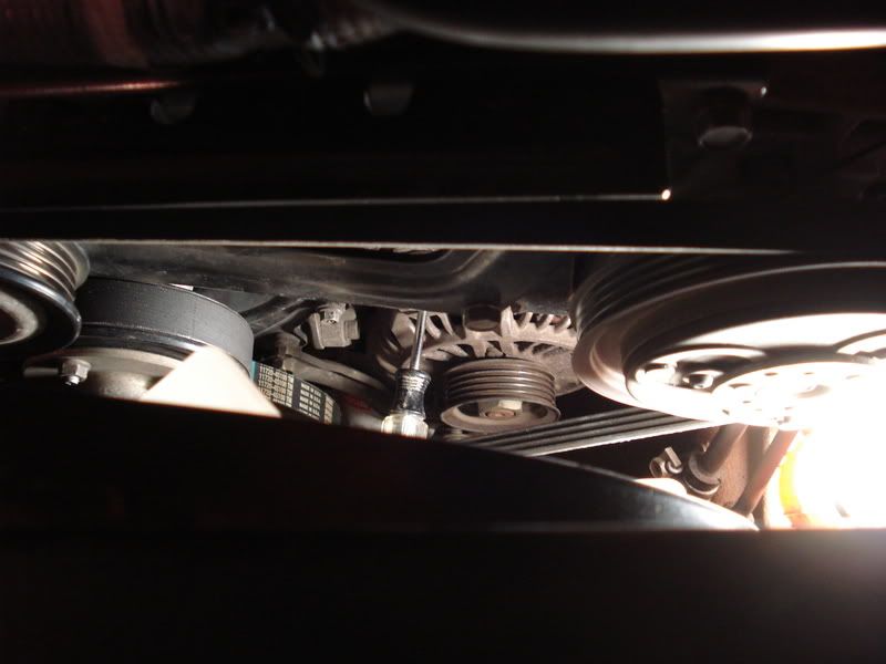

14. Use a phillips screw driver to line the hole up.
15. Install the front upper bolt first and tighten it some what snug. Then install the rear upper bolt. Slide the belt over the pulley. Install the red terminal then the ground wire with your new M5 screw. The rest bolts up as you removed it.
