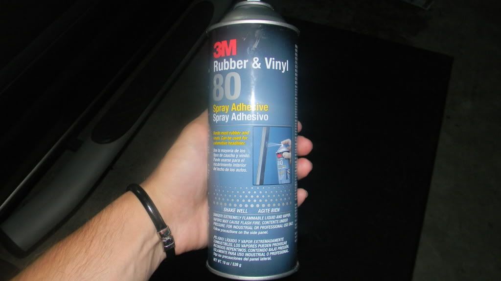

-FOAM-BACKED HEADLINER FABRIC.. MEASUREMENTS ARE: { 90 x 45 } ALTHOUGH I GOT 5 INCHES MORE OF LENGTH AND WIDTH. SO IT WOULD BE { 95 x 45 } THE FABRIC GUY SAID THAT WAS ABOUT 3 YARDS
-3M RUBBER & VINYL SPRAY ADHESIVE.

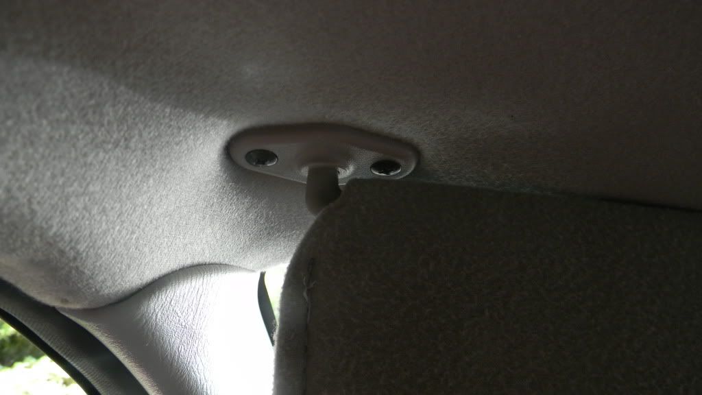

STEP 1. (SUN VISORS/HOLDER)
WE ARE GOING TO UNSCREW THE SUN VISORS ON BOTH DRIVER AND PASSENGER SIDE.
TAKE OFF THE SUN VISOR HOLDER TOO. THEY HAVE A LITTLE CLIP ON IT.

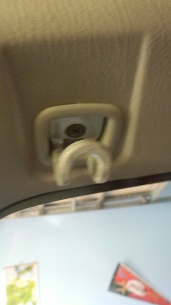

STEP 2.(BACK HOOKS)
UNSCREW ALL THE HOOKS/PLASTIC MOLDINGS AT THE BACK OF THE CAR. ALL THESE PLASTIC MOLDINGS HAVE A LITTLE CLIP ONCE THE METAL HOOKS ARE OUT. POP IT OUT. IT DOES NOT NEED TO MUCH FORCE!!
SEE THOSE TWO HOOK LOOKING THINGS.. GET THOSE OUT OF THE WAY...
THIS IS WHAT THEY WOULD LOOK LIKE TAKEN OFF

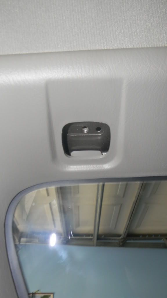

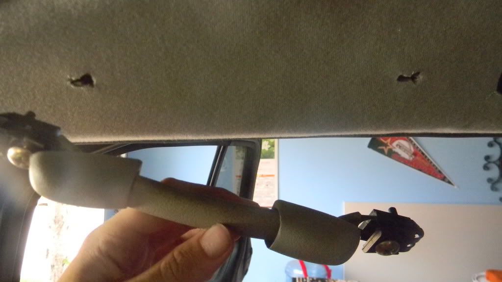

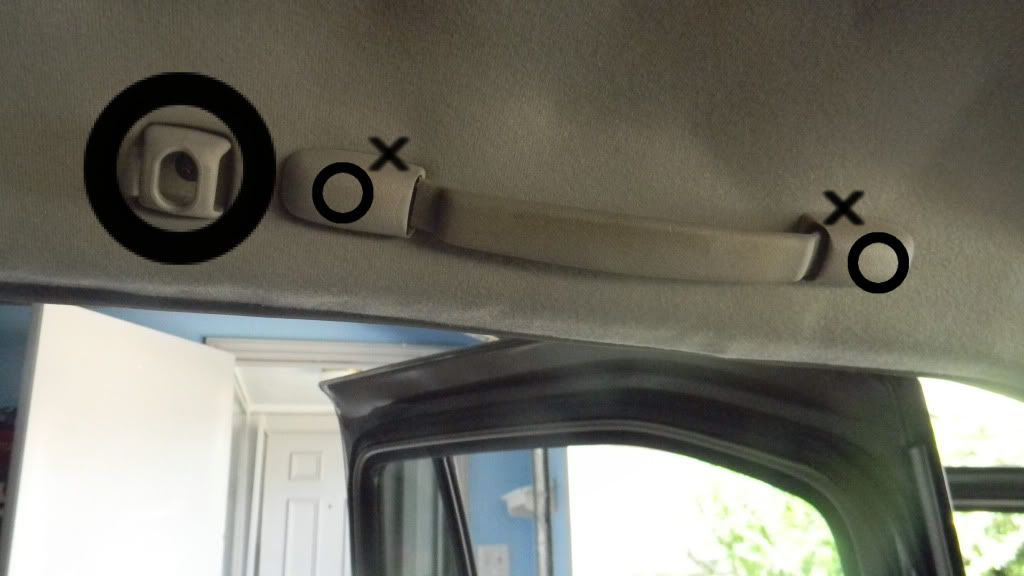

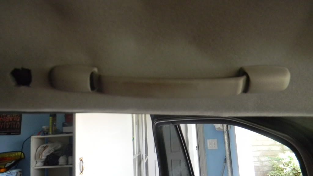

STEP 3A.(BACK HANDLES/2 MORE HOOKS)
OK SO NOW WE HAVE 2 MORE HOOKS AND ALSO THE HANDLES TO TAKE CARE OF.
NOW THE HOOK THING THAT IS CIRCLED NEEDS TO BE UNSCREWED, AND THE PLASTIC MOLDING AROUND IT NEEDS TO POP'D OUT. NOT TO MUCH FORCE NEEDED!

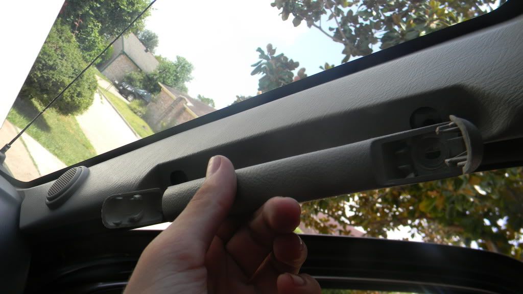

THAT'S WHAT IT SHOULD LOOK LIKE.. NOW WE HAVE TO GET THAT HANDLE OUT. IT'S A LITTLE TRICKY.
GET A FLAT SCREWDRIVER AND GET UP UNDER THERE. YOU'LL HEAR A POP SOUND. THAT'S WHEN YOU KNOW YOU'VE GOT IT.

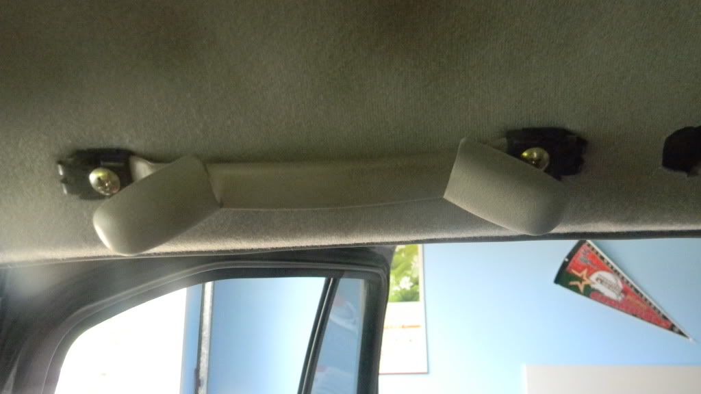

THIS IS HOW IT SHOULD LOOK WHEN YOU POP'D THOSE SUCKERS OUT.
UNSCREW THE TWO PHILLIPS SCREWS AND YOU'VE COMPLETED THE TASK OF TAKING OUT THE HANDLES
DO THIS FOR BOTH THE REAR DRIVER AND REAR PASSENGER!!!!

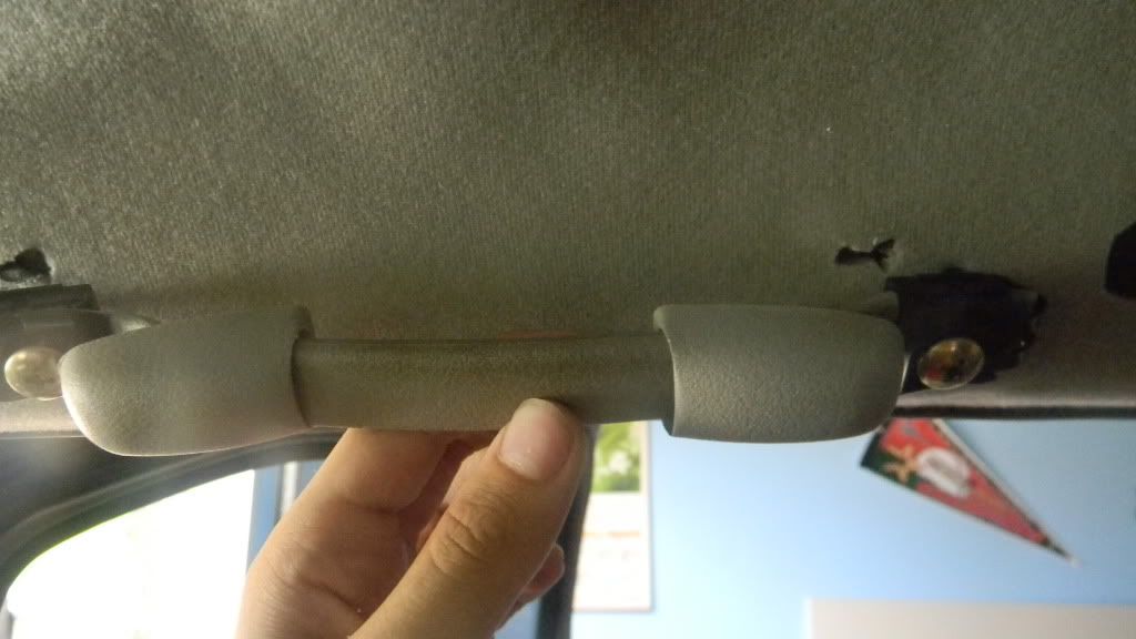

STEP 3B.(PASSENGER SIDE HANDLE)
THIS ONE IS AN ADD-ON TO STEP 3. IT'S THE SAME TASK, BUT THIS HANDLE IS LOCATED IN THE FRONT PASSENGER SEAT.
THIS IS WHAT IS SHOULD LOOK LIKE COMPLETED CORRECTLY.

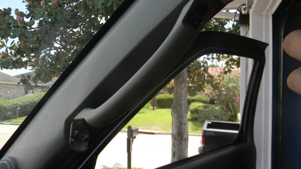

STEP 4.(UP FRONT HANDLES)
THIS STEP IS FOR THE HANDLES THAT ARE LOCATED A LITTLE BIT CLOSER TO THE DASHBOARD. THESE ARE PRETTY SIMPLE TO TAKE OUT.
THEY HAVE A LITTLE CLIP OPENER.. SO YOU CAN GET ACCESS TO THE SCREW. YOU'LL SEE IT! JUST GET A FLAT SCREWDRIVER AND CAREFULLY POP IT OUT. NOT A LOT OF FORCE, IT CAN BREAK EASILY!!!
HOW IT SHOULD LOOK WHEN FULLY TAKEN OUT!! DON'T FORGET TO DO BOTH, THE DRIVER AND PASSENGER SIDE HANDLES!!

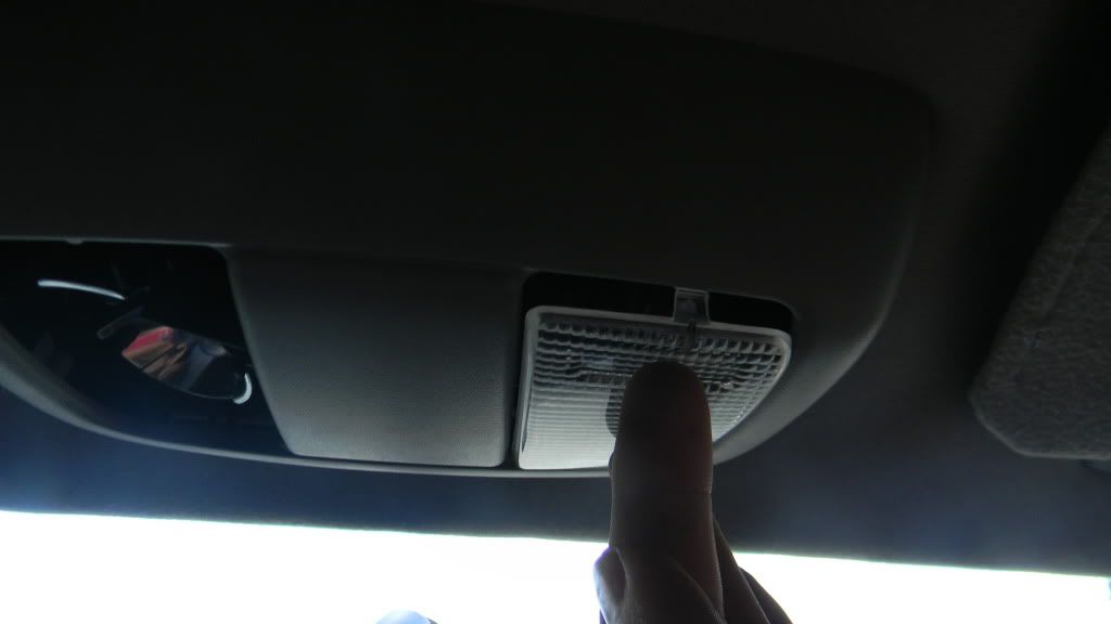

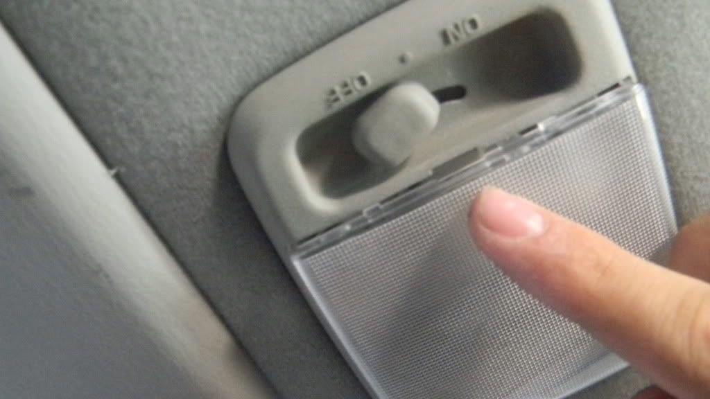

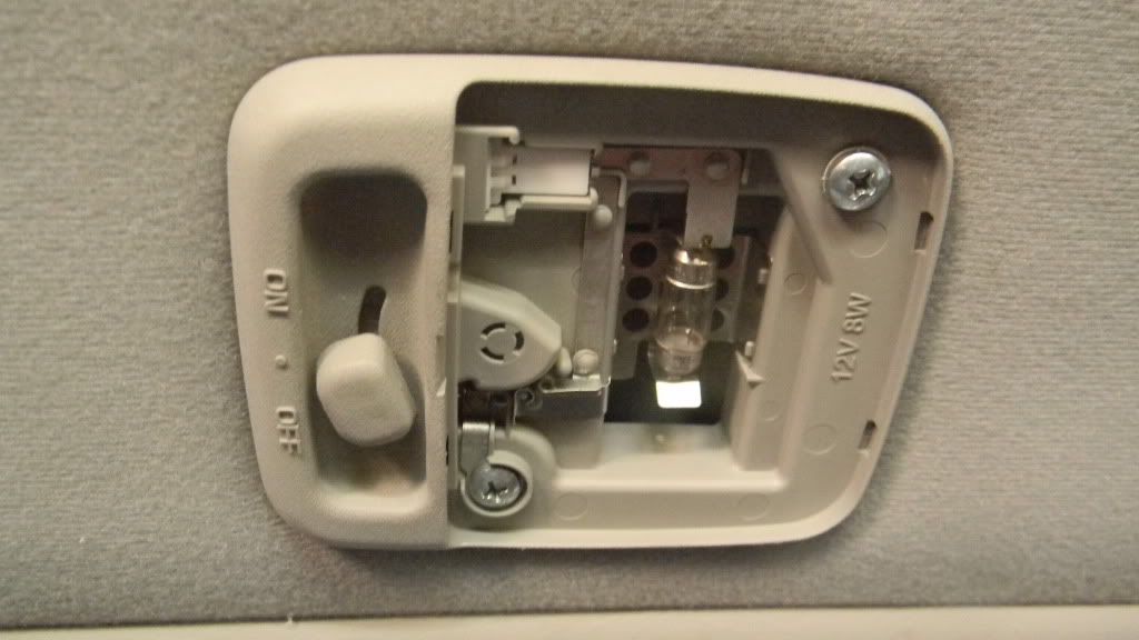

STEP 5.(OVERHEAD LIGHTS)
THIS STEP IS TO TAKE THE LIGHTS OUT THE HEADLINER. THERE ARE TWO OF THESE. THERE IS ONE LOCATED AT THE BACK OF THE CAR, AND ONE RIGHT IN THE MIDDLE.
GET A FLAT SCREW DRIVER AND SLOWLY POP IT OUT. THIS DOES NOT NEED A LOT OF FORCE EITHER.
ONCE YOU POP IT OFF, IT SHOULD LOOK LIKE THIS.
GET A PHILLIPS SCREW DRIVER AND UNSCREW THOSE TWO SCREWS.

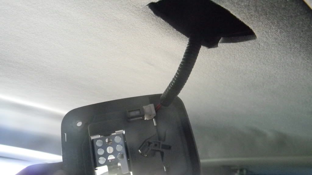

ONCE DONE, CAREFULLY POP IT OUT A LITTLE BIT... IT SHOULD BE HANGING DOWN LIKE THIS. YOU NEED TO THEN TAKE THE CONNECTORS APART.
HOW IT SHOULD LOOK AFTER TAKING OUT THE LIGHT W/ PLASTIC MOLDING.

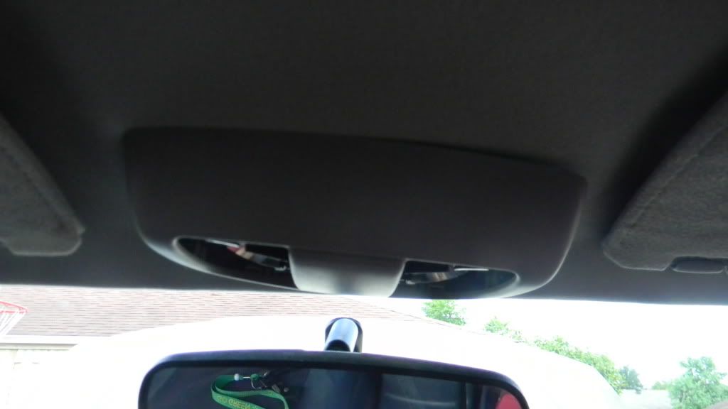

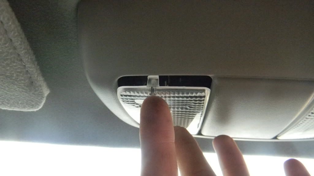

STEP 6.(MAP LIGHT/DOME LIGHT)
THIS STEP IS TO TAKE THE MAP LIGHT IN THE HEADLINERS FRONT PART.
FIRST YOU TAKE OUT THE SMALL PLASTIC/GLASS CLIP.. GET A FLAT SCREWDRIVER.. BE CAREFUL!
ONCE YOU HAVE DONE THAT IT'S TIME TO TAKE IT OUT.
THIS IS GOING TO BE A LITTLE TRICKY. YOUR GOING TO HAVE TO USE A LOT OF FORCE ON THIS ONE. BUT BE CAREFUL NOT TO BREAK ANYTHING!!
THIS DOME LIGHT HAS TWO BIG METAL CLIPS ON EACH END.
YOU'LL HAVE TO BE CAREFUL.. YOU JUST NEED TO STICK YOUR FLAT SCREWDRIVER IN THERE.. AND ONCE YOU GO AROUND IT A COUPLE TIMES IT'LL GET LOOSE. YOU'LL HEAR A LOUD POP SOUND. KEEP IT GOING THROUGH ALL OF ITS CORNERS AND YOU'LL GET IT OUT!
(SEE HOW IT'S POP'D OUT A LITTLE BIT TO THE RIGHT)
NOW THERE'S GOING TO BE ONCE BIG CONNECTER.
GET THAT CONNECTOR OUT AND YOUR GOOD TO GO!

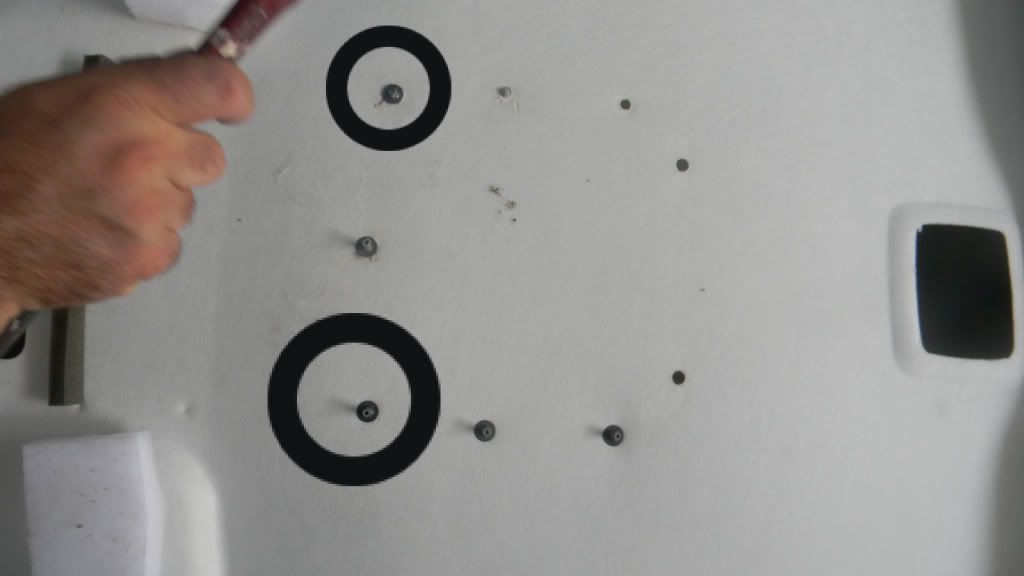

ONCE YOU TAKE OUT THESE FOUR SMALL ROOF CLIPS THERE ARE 2 MORE HIDDEN ONES AT THE BACK OF THE CAR.
NOW THIS PIECE OF PLASTIC HAS SOME METAL CLIPS TO IT. (THOSE X'S REPRESENT THE METAL CLIPS.)
TO TAKE THIS OFF, GET YOUR FLAT SCREW DRIVER AND SLOWLY POP IT OFF. ONCE YOU HEAR A LOUD POP, YOUR DOING GREAT!
WHAT IT SHOULD LOOK LIKE ONCE THE PLASTIC PIECE IS OUT.

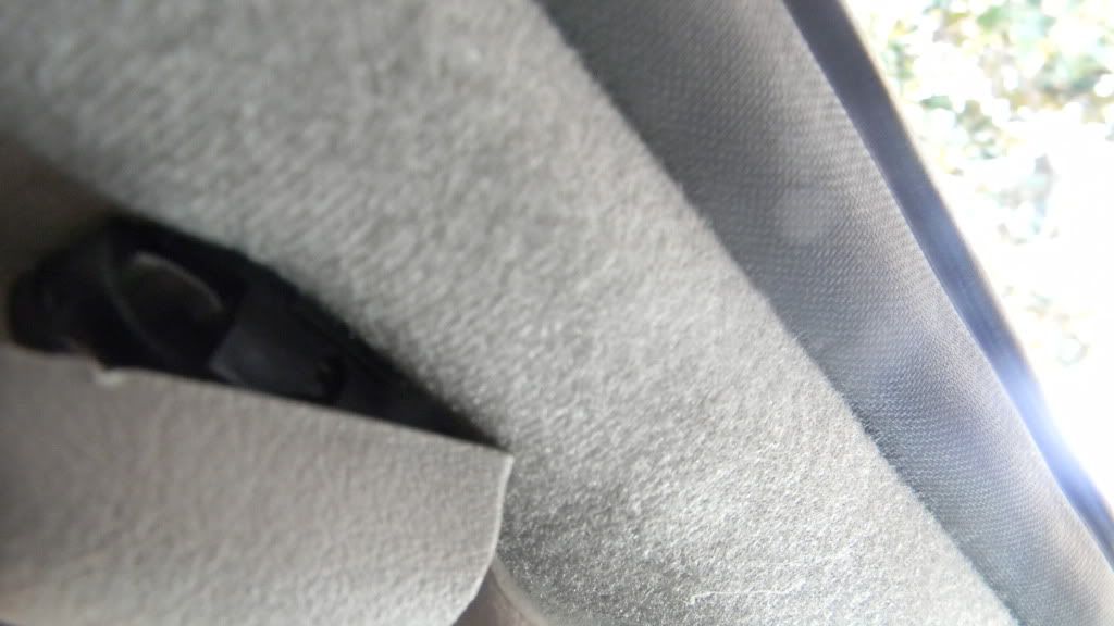

NOW THERE ARE 2 SMALL PLASTIC ROOF CLIPS TO BE TAKEN OUT. JUST LIKE BEFORE, SLOWLY POP THEM OUT. THEY CAN BREAK EASILY!! YOU GOT THIS!!
IT SHOULD BE LOOKING GOOD NOW. THE FABRIC IS SAGGING, AND THERE ARE 2 MORE SCREWS TO UNSCREW.. AND YOUR ALMOST THERE.

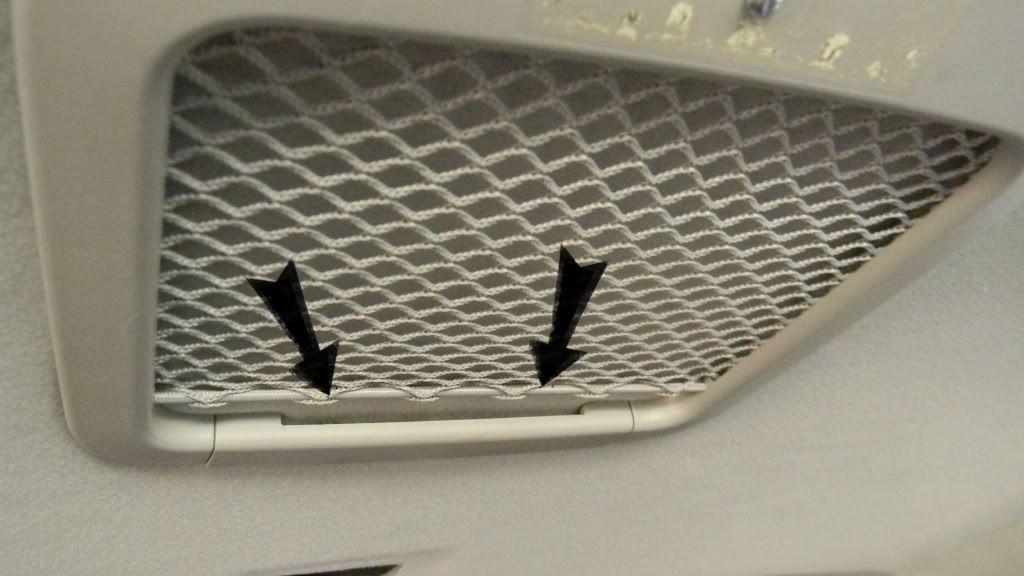

STEP 8.(STORAGE ROPE ROOF)
*NOTE THAT THE EXTRA 1 SCREW IS AN AFTER PICTURE.. AND THAT IS WHAT WE ARE GOING TO DO TO IT AFTER WE CLIP THOSE PLASTIC THINGS.*
OK HERE IS THIS SORT OF STORAGE AREA FOR MISC. ITEMS..
YOU CANNOT TAKE THIS OFF WITHOUT BREAKING IT... IT IS APART OF THE HEADLINER!!! SO JUST WAIT UNTIL THE WHOLE HEADLINER IS OUT, THEN WE WILL START MOD'ING IT.
TO TAKE IT OFF, YOU NEED TO POP THIS OUT WITH YOUR HAND. IT'S REALLY SIMPLE. ALSO KEEP IN MIND, NOT TO MUCH FORCE.
THIS IS WHAT IT LOOKS LIKE WITH THE PLASTIC OFF. IT HAS A LITTLE STRING ATTACHED TO IT. DO NOT BREAK IT, IT'S SUPPOSE TO BE THERE.
NOW JUST UNSCREW THOSE 2 BLACK SCREWS. IT WILL NOT MOVE AT ALL. LIKE I SAID.. IT IS ATTACHED TO THE HEADLINER.. DON'T PULL OR BREAK IT, LEAVE IT ALONE!! WE'LL COME BACK TO IT!!!
NOW WERE ALMOST THERE!!! IT'S ALMOST OFF! NOW WE JUST NEED SOME HARDCORE FORCE/PULLING!! MAKE SURE EVERYTHING IS OUT OF THE HEADLINER. NO SCREWS, LIGHTS, HOOKS, HANDLES.. EVERYTHING IS OUT AND PLACED NEATLY SOMEWHERE WHERE YOU WONT LOSE IT!

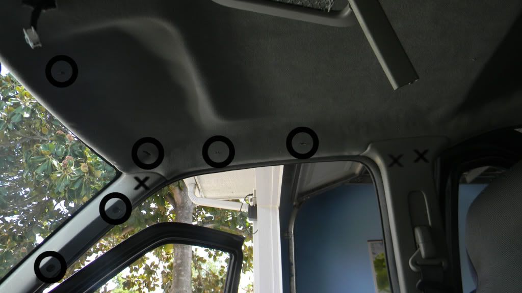

STEP 9.(TAKING THE HEADLINER OUT)

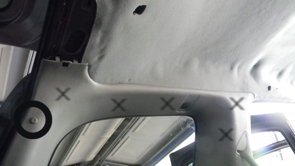

THIS STEP CONSIST OF POP'ING OUT SOME METAL AND PLASTIC CLIPS ON THE SIDE PLASTIC MOLDINGS TO TAKE OUT THE HEADLINER!
WE ARE GOING TO START FROM THE BACK AND GO TO THE FRONT!
NOW COMES THE HARD PART. THE X'S MARK WHERE SOME OF THE METAL CLIPS ARE IN PLACE. FIRST OF ALL, YOU ARE SUPPOSE TO TAKE THESE LITTLE PLASTIC CLIPS WERE I MARKED WITH CIRCLES. FOR THESE JUST GET A FLAT SCREWDRIVER AND POP EM' FULLY OUT. (THERE ARE 2 ON EACH SIDE) CAREFUL NOW.. ONCE THAT IS TAKEN CARE OF.. YOU NEED TO PULL OUT THE PLASTIC SIDE MOLDING. THIS STEP REQUIRES SOME FORCE. ALTHOUGH NOT SO MUCH FORCE.. WE DON'T NEED TO BREAK ANYTHING RIGHT NOW! ONCE YOU GET ONE SIDE OF THE PLASTIC MOLDING, IT'S TIME FOR THE OTHER SIDE.
IT'S BASICALLY THE SAME THING. TWO SMALL CLIPS THAT I HAVE CIRCLED.. AND THE X'S REPRESENT METAL CLIPS.. THE TWO X'S THAT ARE FARTHEST TO THE RIGHT ARE PLASTIC CLIPS.. THE REST ARE METAL CLIPS.. BE CAREFUL HERE... IT'S GONNA REQUIRE FORCE TO POP THEM OUT.. YOU'LL HEAR A LOUD POP WHEN YOU GET THEM OUT!
ONCE YOU POP'D THOSE TWO SIDE MOLDINGS, YOU GOT SOME MORE PULLIN' TO DO!

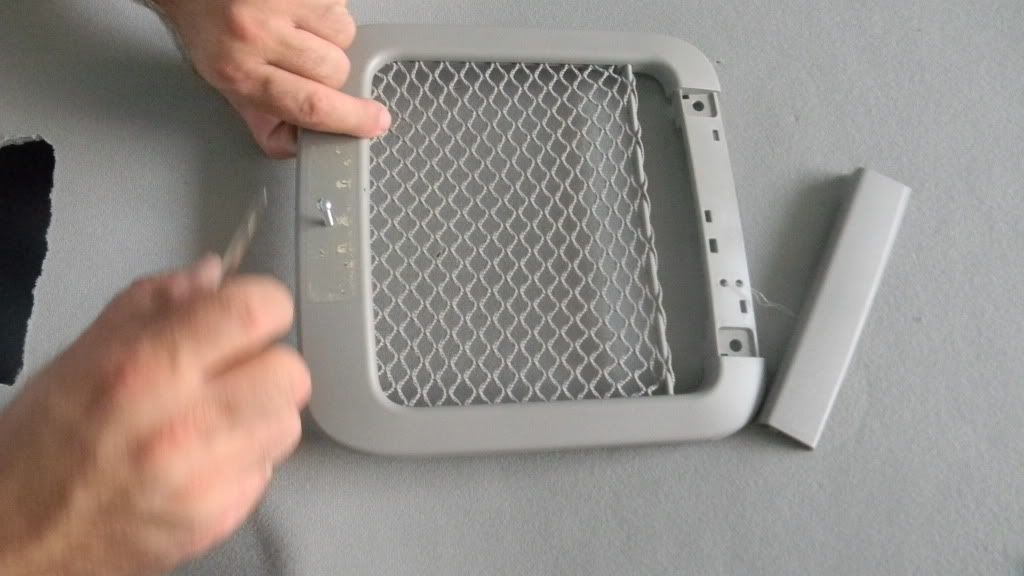

STEP 12.(TAKING OUT THE STORAGE AREA)
SO THIS LITTLE STORAGE AREA IS COMBINED WITH THE HEADLINER, YOU'LL SEE IT ONCE YOU TAKE THE WHOLE HEADLINER OFF..
THERE ARE 6 SMALL PLASTIC THINGS THAT HOLD THE STORAGE... YOU CANNOT TAKE IT OFF, UNLESS YOU BREAK THOSE THINGS.
WHAT I DID WHAT BREAK THOSE PLASTIC THINGS, AND POP'D OUT THOSE METAL CLIPS... AND GLADLY THE STORAGE CAME RIGHT OFF THE HEADLINER..
WHAT I DECIDED TO DO IS PUT A SCREW RIGHT THROUGH THE PLASTIC STORAGE THING, AND THROUGH THE HEADLINER...
I DRILLED IT DOWN, JUST TO GET THE THE HOLE FOR THE SCREW TO PUT IN, AND SET IT ASIDE.
SO NOW YOU HAVE SOMETHING TO HOLD IT UP..

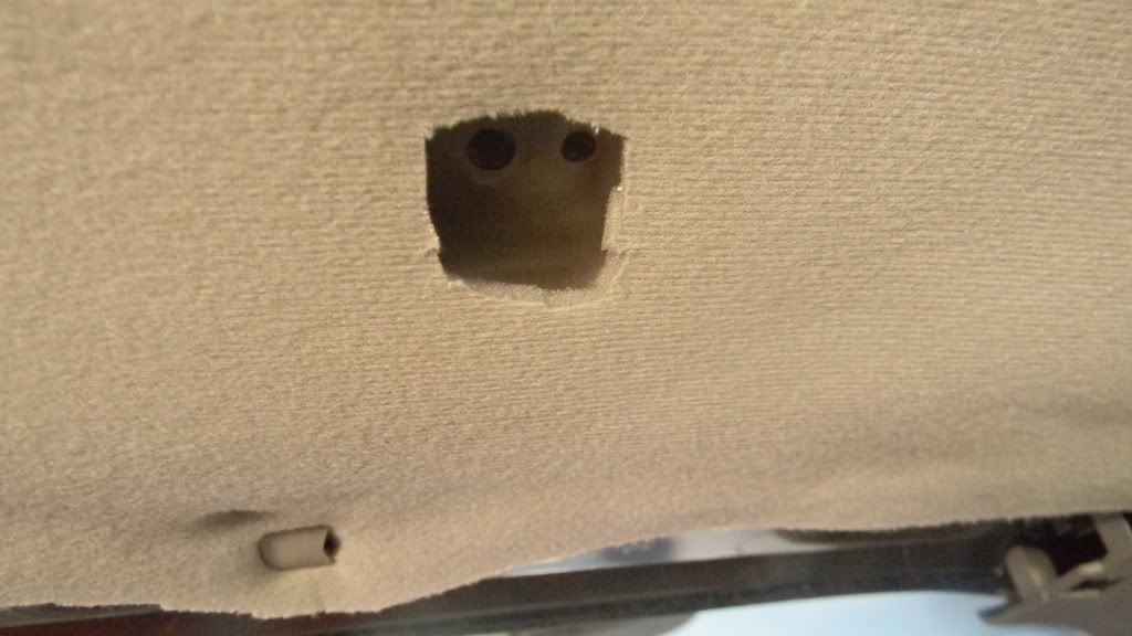

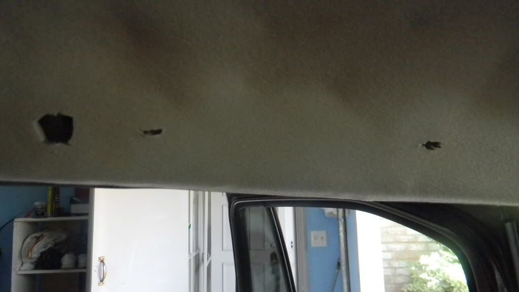

NOW ALL WE NEED TO DO HERE IS CUT SOME EXTRA FABRIC OFF AND CUT THE HOLES WERE THE LIGHTS/SCREWS/HANDLES/HOOKS NEED TO BE..
EXAMPLES OF HOLES CUT FOR HANDLES/HOOKS..
ONCE YOU CUT OUT THE HOLES NEEDED TO BE CUT, WE NEED TO CUT EXCESS FABRIC IF YOU HAVE ANY... MAKE IT LOOK NICE.

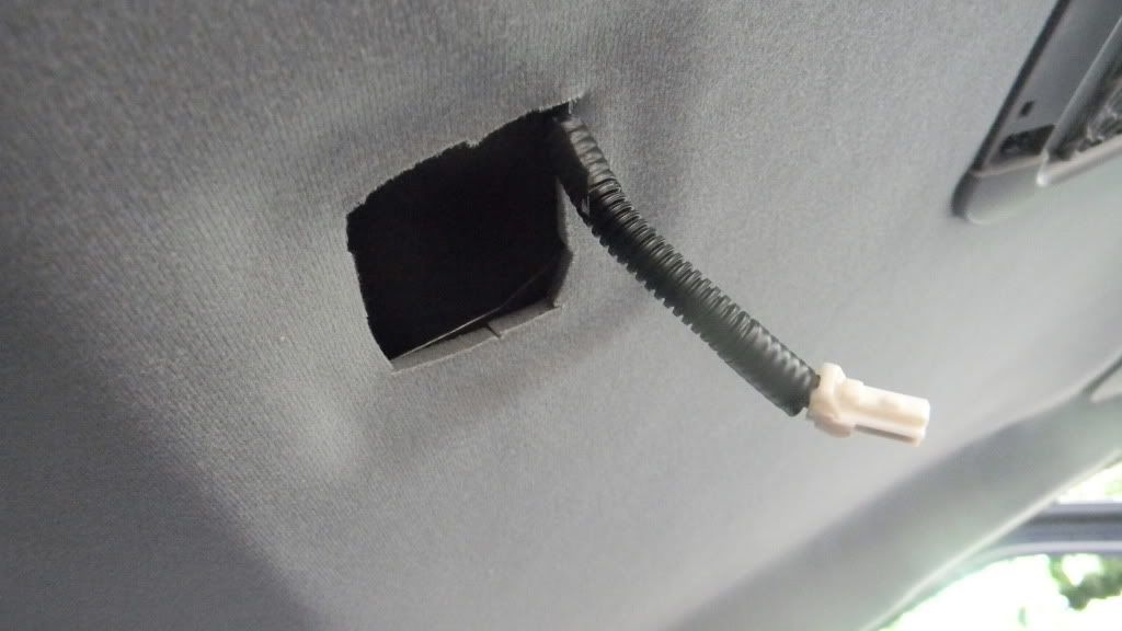

STEP 17.(PUTTING IT BACK)
ALL THAT IS LEFT IS PUTTING IT BACK INTO THE CAR, AND SCREWING EVERYTHING IN/ POP'ING THE PLASTIC BACK IN PLACE...
TO PUT IT BACK TOGETHER, IT IS THE SAME PROCESS AS YOU TOOK IT OFF, BUT OPPOSITE... IT IS GOING TO BE A PEACE OF CAKE PUTTING IT BACK IN SINCE YOU ALREADY KNOW WHERE EVERYTHING IS BY NOW.. SCREW EVERYTHING IN, HANDLES/LIGHTS/BACK PLASTIC PIECES/LITTLE ROOF CLIPS/ SIDE SMALL PLASTIC CLIPS IN THE BACK... ALL THAT GOOD STUFF..
DO NOT FORGET THE WIRES FOR THE LIGHTS, GET THEM OUT FIRST BEFORE SCREWING AND POP'ING THE PLASTIC IN THERE FIRST!

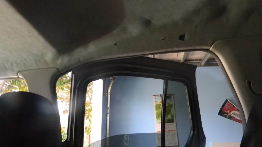

IT'S ALL COMPLETED.. SOME COMPLETION PICS
NOW LOOK, IT DOES NOT LOOK LIKE THE BEST HEADLINER JOB EVER.. I KNOW THESE PRO'S CAN DO BETTER THAN ME, BUT PAYING THEM 245$ FOR SOMETHING I COMPLETED IN 5 HOURS AND COSTED ME 50$.. I'D RATHER DO IT MYSELF.. IT SAVED ME MONEY, AND GAVE ME A FEELING OF SATISFACTION..
