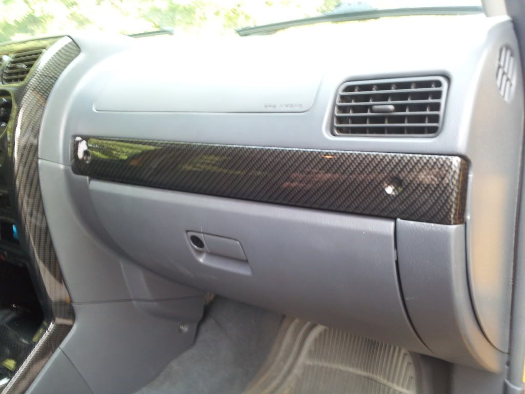

Next was a fun mod just messing around with a friend to spice up the interior and test out what hydro dipped gold carbon fiber looked like.

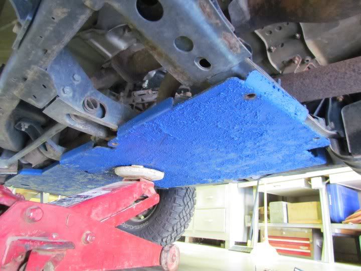

After that I had a full set of skid row skid plates waiting to be installed. I also picked these up off of Yellowmonsta for $300. I also painted these the blue color I have been painting other things. I also picked up all brand new hardware from skid row for $23 shipped. This was all in prep for the ECXC i knew I would be there for 3 days.
The install took me 5 hours by myself trying to figure everything out and get everything into place.
After a bashed finger and 5 hours, success.This was also a week before ECXC. ha you see the trend it? I wait until the last minute before a trip for me to do stuff that needs to be done.

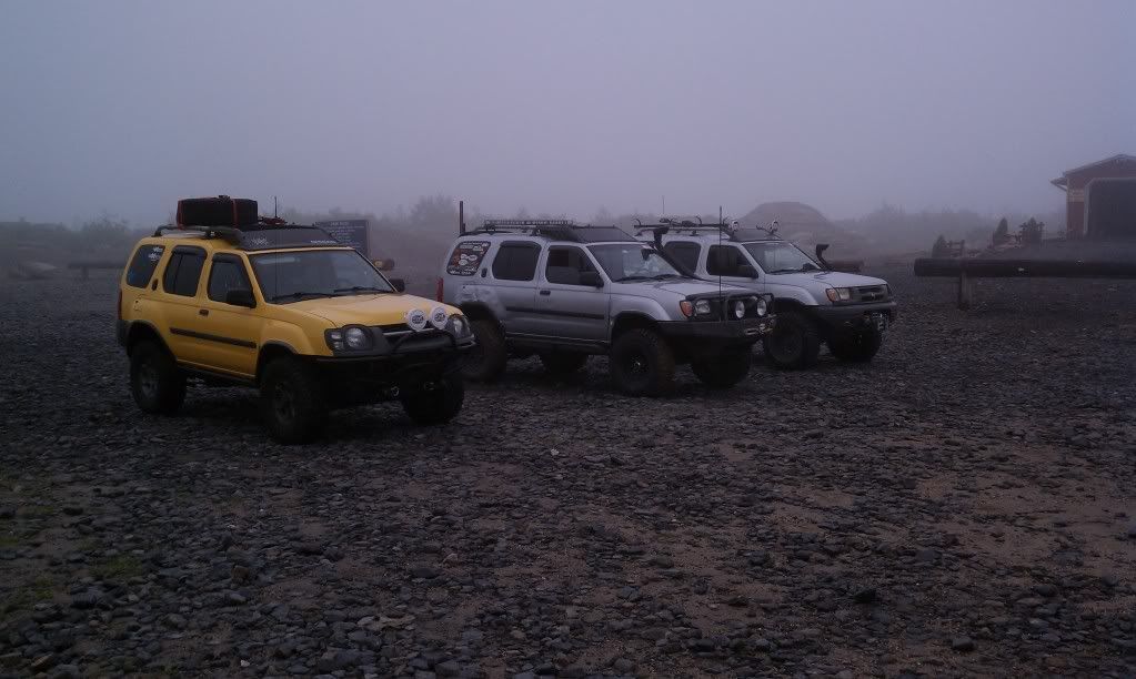

So Thursday morning me and my friend load up and 545am and head out to Rausch Creek. So we stay there till saturday and have a blast with some great people and great weather.

Looks good man, love the carbon fiber interior
