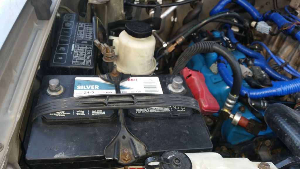

1. remove battery cable 10mm

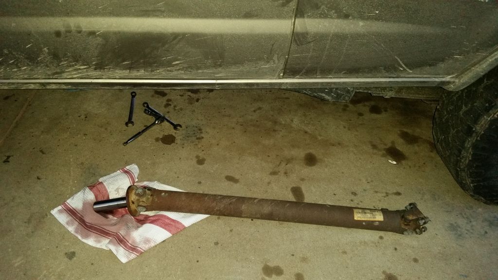

6. remove drive shaft 17mm

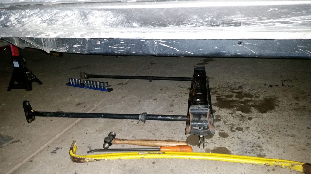

7. remove the torsion bars 17mm 14mm

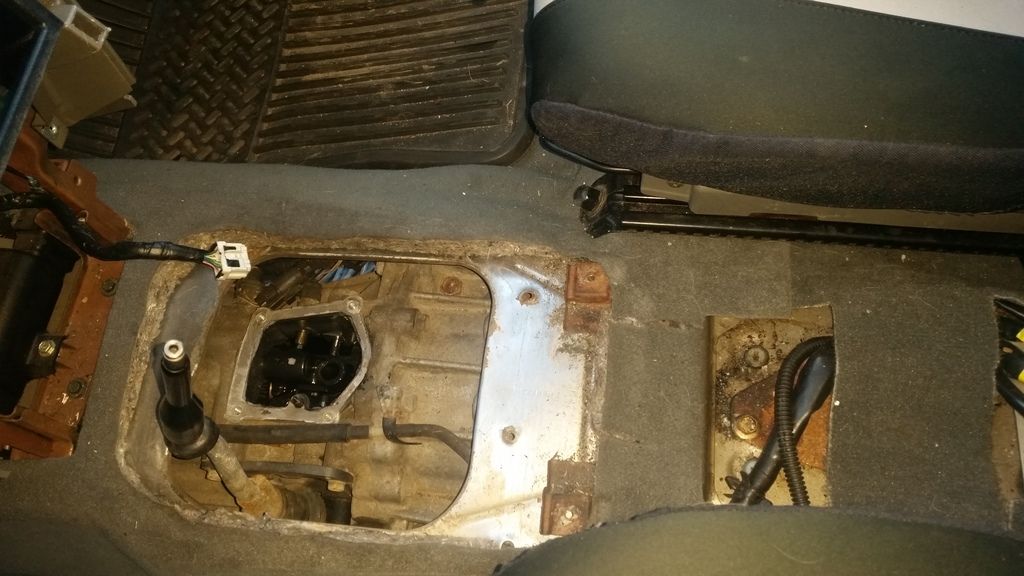

10. remove center console

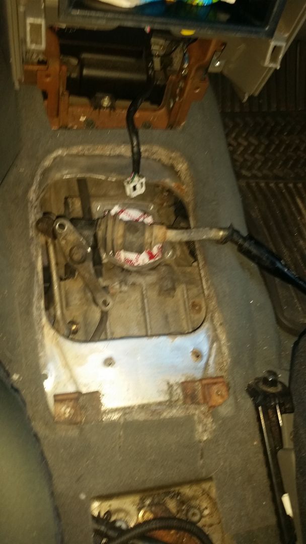

11. remove the shift boot
12. remove the transmission shift 12mm
13. remove the 4x4 shift 12mm
