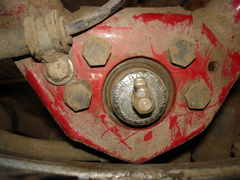

Ok, so I just discovered that my driver's upper ball joint is completely thrashed. Now I've got the rancho UCA's on here, and I'm not sure how I can know if a stock replacement ball joint would work. Is this an aftermarket only setup? Is there something special about the Moog Problem solver? Does it operate at special angles or something? Where should I be looking for a new ball joint? None of the parts stores around here even show a listing for them! Here's a pic of what's in there.

Not looking at a balljoint spacer, just trying to replace a busted balljoint. The only question is whether a stock replacement will work, or if this is some sort of specialized aftermarket moog application. There's 4 bolts holding into the UCA as shown, and a tapered/threaded stud holding it into the knuckle. Normal style mounting.

looks the same as my AC setup, measure the distance between the bolts holding it on
and either json or myself will measure ours, if they measure the same you should be able to get it from AC wit no prob, looks the same as my setup for sure(just rancho)

Sweet! Yeah, it's been a while since my SL, but there are not 4 bolts. I will say however that it does appear a lot like Calmini's BJ's that they use. I am positive that these are an easier find.
If you look closely, you can see the bolts here on my POS Calmini UCA's

Ok, so for future reference, I got the part numbers out of the installation instructions for the rancho kit. Same numbers I was seeing in threads for the Calmini lift. It is the same old HB/Pathy BJ. FA1227 is a common one.
