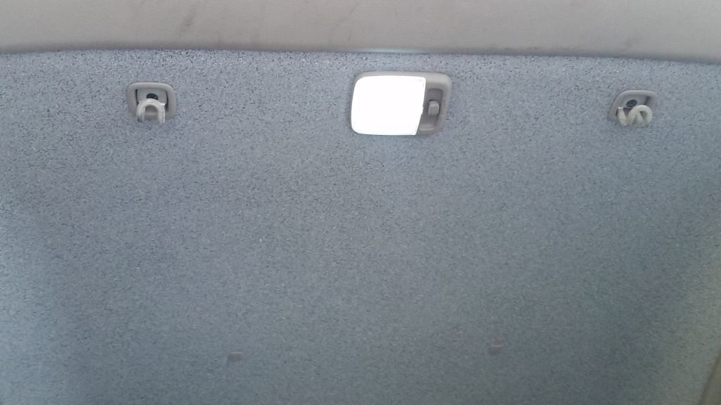

Anyway, Lazarus had the same problem all older trucks seem to develop - the darn headliner kept trying to engulf me. It was getting unmanageable. So a couple weeks ago I grew a pair and attacked the project. I had decided I did not want to put fabric back up since I may very well end up having to do it again. So, I decided on paint. I tore out all the trim and removed the headliner board. Got it inside at a friends shop. Peeled off all the old fabric, then hit it with a brass wire brush to clean off all the old cruddy foam. Wiped down with solvent and dried. The whole process was actually a lot easier that I had expected.
On to paint. I shot it with two coats of #2081 Rustoleum Light Gray Primer, waiting a day between coats. Took about 3 cans to get a good even coverage. Actually looked pretty good, but the fiberglass board did have a few minor ripples in it and they were glaring with a solid color. I wanted something to give me a little random textured finish to hide any irregularities. I found it in Krylon Make It Stone (#18201 Black Granite). I got a little nervous when the can said it covered 6 sq. ft., sounded like it was gonna get a little expensive! Still I figured I'd never have to do it again. And when I got into painting I realized that the listed coverage was if you were looking to get the same heavy dark finish that was on the cap. That's not what I wanted, I just wanted texture on top of the gray that was already painted on. In the end I used the Krylon, spaying from about 2 ft from the surface and keeping the can moving pretty fast to get just what I wanted. Only took two cans for the look I was after. Here's a few pics:
The lighting in the shop sucked - pic shows a horrible yellow tint - this is NOT an accurate color.
This is the texture I got - looks like I had a custom granite headliner cut for me.
The look from the rear cargo area.
And here's how it looks from the passenger front seat.
