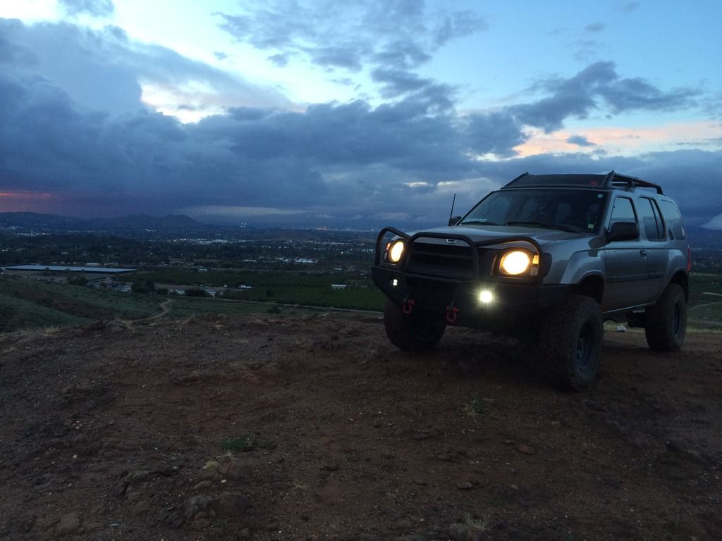

Very Nice Start! Mine is the same color but an '01 and I was wondering how painted black rims would look on mine (I lack the visual imagination to picture it). I do like the look! Wish I could take off the site steps but some people (ahem, g/f, ahem) would complain of being able to get in and out. I guess being 6'2" I never give it a second thought.
I was going to mount a light bar on mine in the same spot, let's face it, the stock lighting of the Xterra is very poor. Where did you run your wires through to the interior? Any picture of your install of the lights and where you put the switch inside? Just looking for some ideas before I decide to go through with it.
Lastly, in regard to the airbox mod thing, any change in power, MPG, sound? Is it worth it or just get more of a growl?

Thank you! Yah I really like the look of black rims a lot. I'm around 6 ft too so it doesn't bother me either and (luckily) my gf got used to it over time haha :D
I'll get some picture of the light bar wiring when I get home later today, it would be a little hard to explain with no pictures. But you'll be happy to hear it is fairly simple, I'm no electrician and I figured it out pretty easily.
The intake mod claims to gain you about 5-10 HP (nothing really noticeable), but I have been getting more miles on each tank so my MPG went up for sure! Along with that there is a slightly deeper exhaust sound which I like.
The K&N Filter is definitely the heart of the mod though, after installing that is when I noticed the most difference.

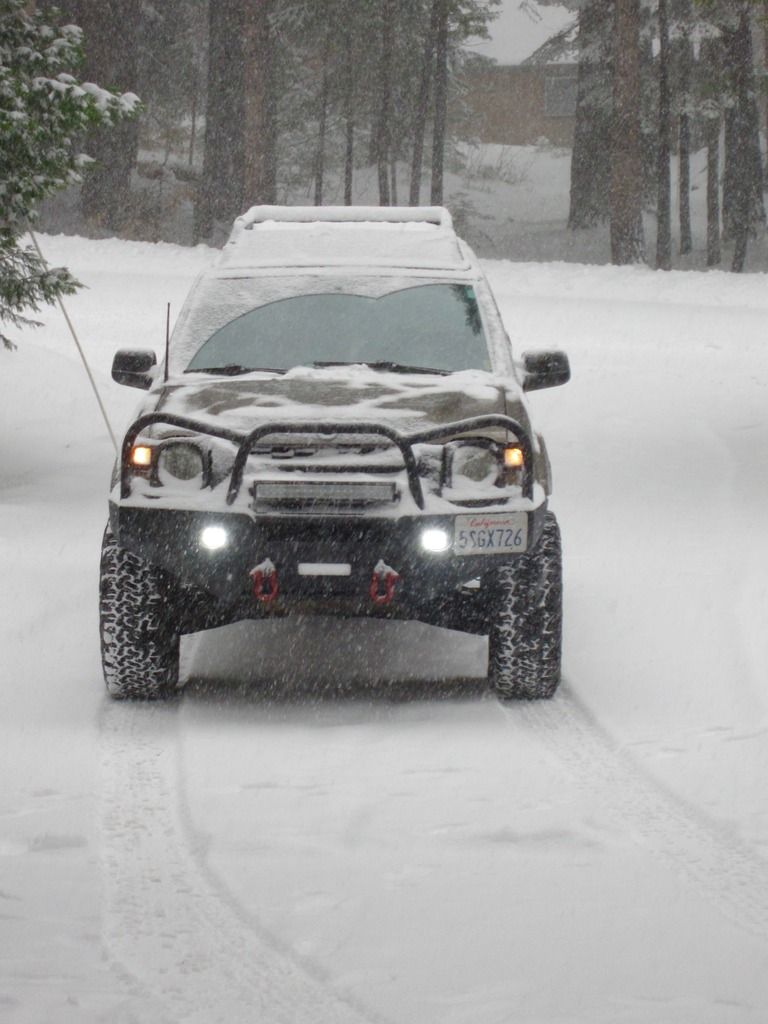

You get any glare on your windshield or hood for the light bar being up top or is it back far enough you don't get that
Sent from AutoGuide.com Free App
Since its up high, I've angled it so the beam goes right in front of the car. So no annoying glare on the hood at all!

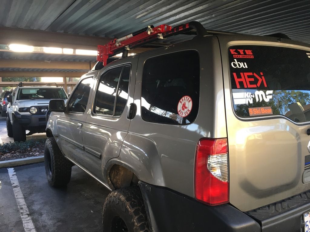

Nice going so far.
Just an observation,are your rear shocks mounted upside down?
787 Posts
Discussion Starter · #15 ·
Nice going so far.
Thanks man! And I do not believe so, the "sleeves" on the shocks had drain holes for water to get out on the ends closest to the ground. So I'm pretty sure they were meant to be mounted that way.

Monotubes like the 5125 can go either way, IE: They work upside down too, etc.
The 5125 comes with added protection to run that way for example.
:D
BTW - WHICH 5125 did you get?
The 255/70 valving is probably what you'd have wanted...
and
What extended/compressed lengths did you go with?
If you have the part #, I can look it up: It would be 33-XXXXXX (33 dash six more digits).
787 Posts
Discussion Starter · #19 ·
and
The extended and compressed length is somewhere around 24" and 15". I'm not sure on the valving though lol so here's the part number: 33186542
I know they aren't giving me my maximum potential flex, but for what I do and my budget they work great!
Sage Mentor/Moderator
12,216 Posts
Hmmm, well, the OEM shocks were 23" long...and, you replaced them with ~ 24" long shocks....not much improvement.
(An inch DOES make a noticeable difference, but is less dramatic an improvement compared to THREE inches etc)
Those ARE 255/70 valved , which is good.
You WOULD have been better off getting 33-185552 instead of 33-186542 though, as they still fit compressed, but, would extend to more like 26", 2" more than you have now. (For ~ the same price)
That would have improved you from 23" stock to 26", instead of only to 24"....with the same 255/70 valving, etc.
In fact, the one's you got are about the same size as the Calmini's you replaced because they were too short.
On the plus side, the Calmini's were crappy twin tube and not state of the art monotubes, and, the Bils are going to ride and handle much better even if the wheel travel is not improved.
