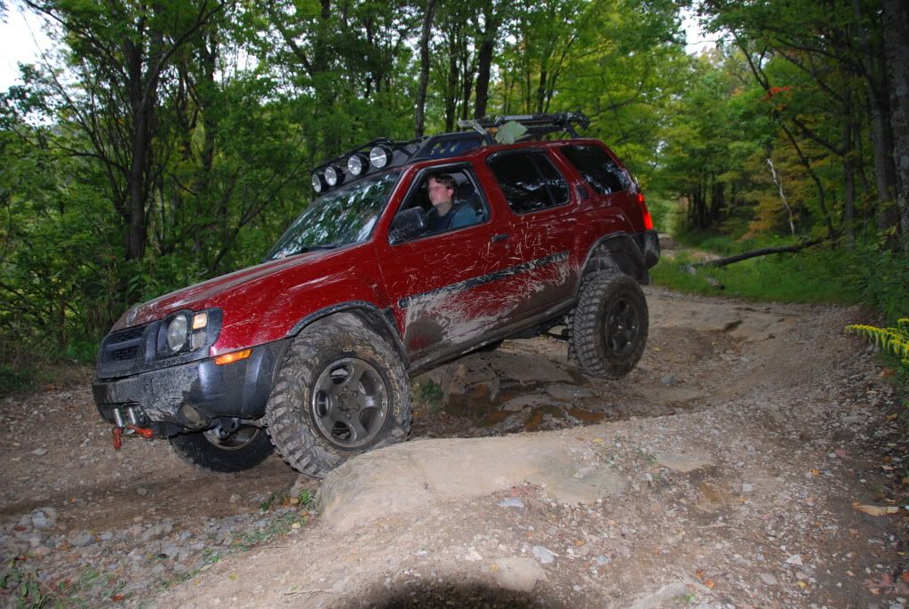

a 285/70/17 will be a ~33x11.5 tire. I like the stock 17's too, but be prepared to spend way more for tires on 17's.
My 285/70/17 Goodyear Wrangler MT/R Kevlars
those look pretty good.
also, really digging your roof lights, is that a custom setup or a kit?

Originally Posted by EddyV View Post
Also, did you have to put wheel spacers in?
Wheel spacers INCREASE TIRE RUB on IFS set-ups.
They do help with the rear live axle though.
You only NEED them if you increase your REAR wheel travel enough, and have at LEAST 12.5" wide tires....and then, ONLY in the rear.
305/65/17 would be as close as you'd get to to a 33x12.5/17 equivalent tire size.
285/70/17 would be like a 33x11.5/17.
-TJ
