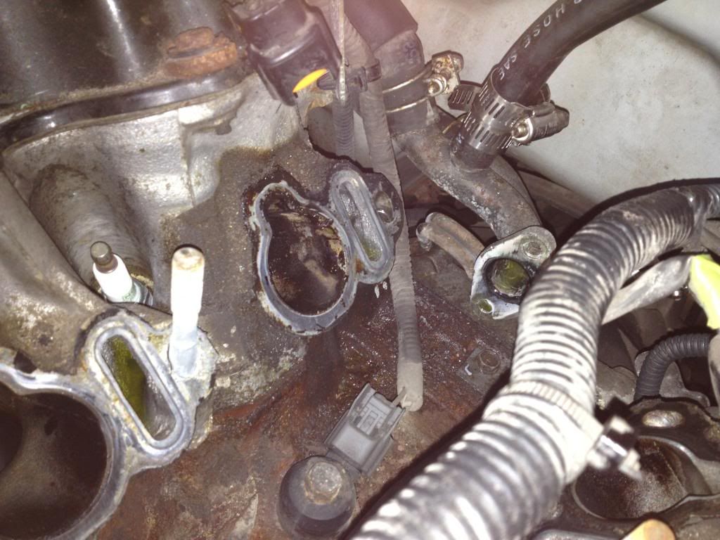

does that look like a bad intake manifold gasket coolant leak??
thx
[IMG][/IMG]
[IMG][/IMG]

Looks like you have this one thoroughly worked out haha! Nice job! Replace the gasket and clean out the Intake and you shlould be good to go.

I'll change the headgasket since i'm all the way there
